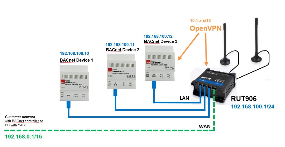

Apologies for the delay. Could you kindly provide a simple topology diagram including the IP addresses of your planned setup? From your current description, as I understand it, you have two separate networks, with the BACnet controller connected to LAN1 (customer network) and your BACnet server on LAN2, correct?
At first glance, this configuration should be achievable with the RUT906; however, having the full topology and addressing plan would help to confirm the details
Hi Martynas
thanks for your reply. I have the topology diagram as apendet. So far we need the access for the customer for our BACnet applications behind the Teltonika router.
Via VPN we connect our self to the BACnet devices for general application configuration. Here no access to BACnet necessary.
The used IP addresses are examples, but a mirror of our application.

Apologies for the delay, and thank you for the clarification and for sharing the topology diagram. Could you please confirm whether the communication between the customer’s network and the BACnet devices behind the Teltonika router has been successfully established?
If it’s still not working, adding a static route to 192.168.100.0/24 via the RUT’s WAN IP as the gateway should be sufficient to enable communication in this type of setup.
