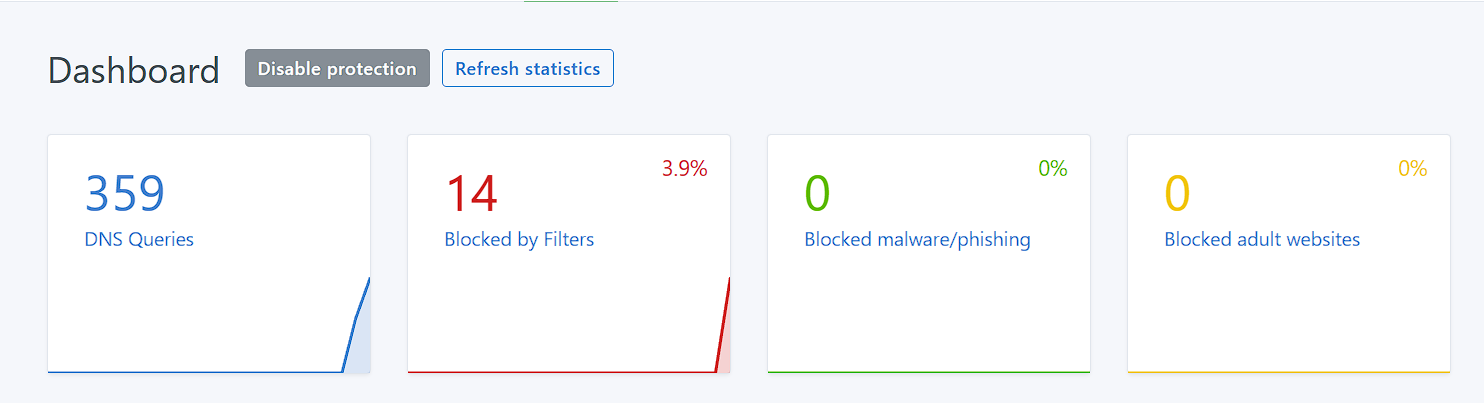

I have used AdguardHome on a RUTX11 before, it has enough memory to handle both the Adguard DNS and Adaway default block lists.
If you install it, be sure to put the stats.db and sessions.db in /tmp else the flash will take a hit.
@flebourse So you added the package repository for it manually after the upgrade to 7.06?
Because if so I would be interested in your opkg configure.
To install:
opkg update
opkg -e /etc/opkg/openwrt/distfeeds.conf update
opkg -e /etc/opkg/openwrt/distfeeds.conf install adguardhome
Edit /etc/init.d/adguardhome, add:
/bin/mkdir -p /tmp/var/adguardhome/data /opt/var/adguardhome/data/filters >/dev/null 2>&1
/bin/ln -sf /opt/var/adguardhome/data/filters /tmp/var/adguardhome/data >/dev/null 2>&1
just before the “procd_open_instance” line.
This will ensure that the truly temporary files stay in /tmp and the filter files are stored in flash memory.

Nice it worked. and that kind without any issue. Nice
