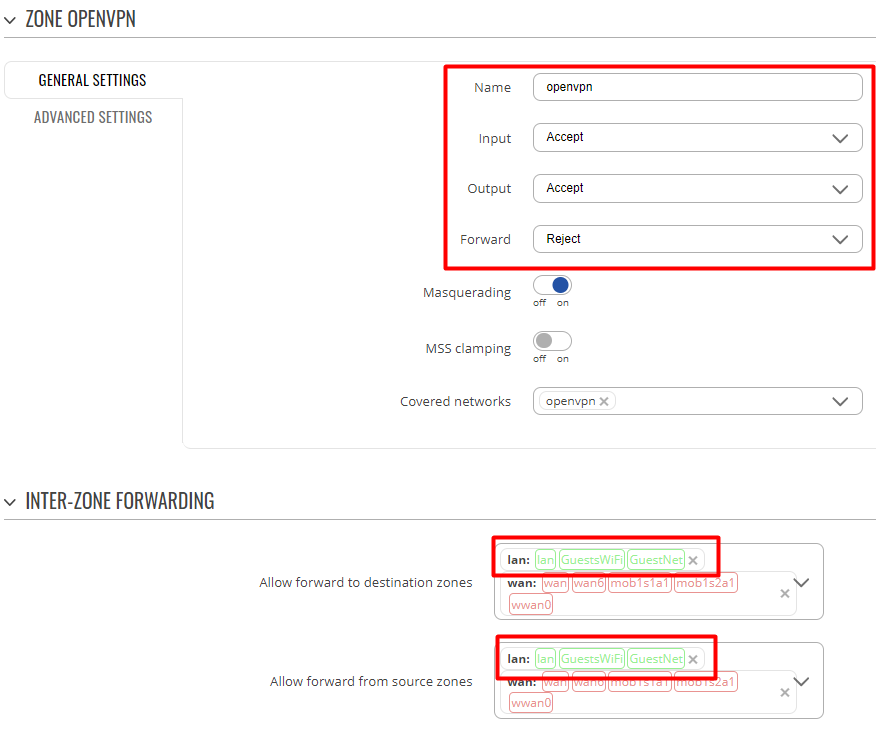

Make sure that OpenVPN zones is configured to allow forwarding to LAN zone:
Regarding a guide, there are a few articles available on our wiki. The most relevant ones for your case would be here and here.

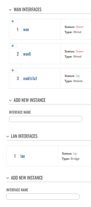

I think i’m missing something in the network configuration also, because I do not have an “openvpn” network to select.
Here are my network interfaces
What firmware version are you on?
The OpenVPN network may not appear in the covered networks for Firewall zone on the older firmwares, but it should work. Perhaps you updated the device to the latest firmware with ‘keep settings’ option? If so, could you please try resetting the device to factory defaults and reconfigure it?
