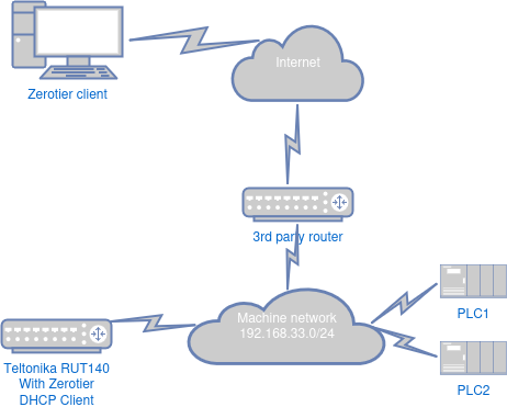

The desired configuration is something like this:
Thank you for the topology.
In this case, make sure that my previous two points are configured properly:
  • Configure a route in ZeroTier to direct traffic for 192.168.33.0/24 through the specific RUT140 device.

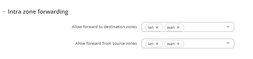

  • Adjust firewall settings on RUT140 by checking the firewall zone settings (Network → Firewall → Zones). Edit the ZeroTier zone and allow traffic to flow both ways between ZeroTier and the WAN zone. So something like this:
