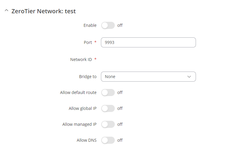

    Services → Vpn → ZeroTier → Add new config name → Dont change anything beside Network ID and turn off allow managed ip. so the config looks like this:
I turn it on (both instance and node) → Save and apply

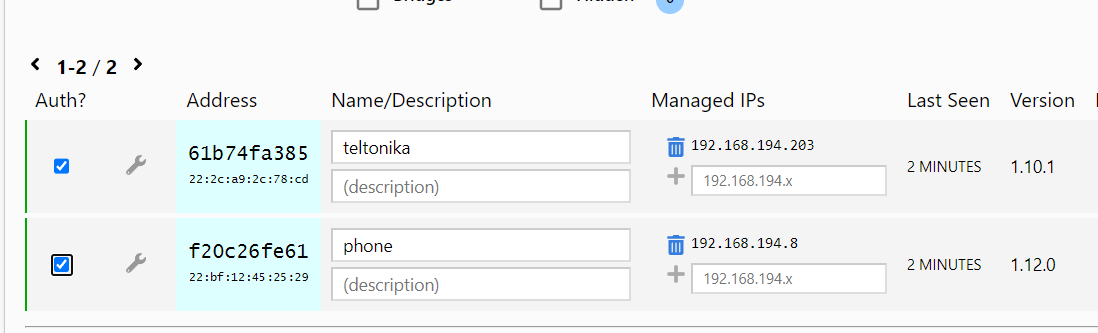

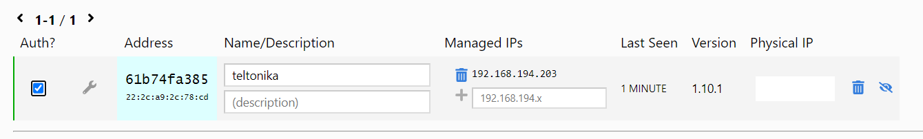

2. On freshly created ZeroTier Network i authenticate router,
  1. On same ZeroTier network i add client - mobile phone and authenticate it.

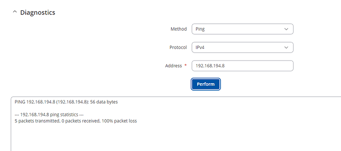

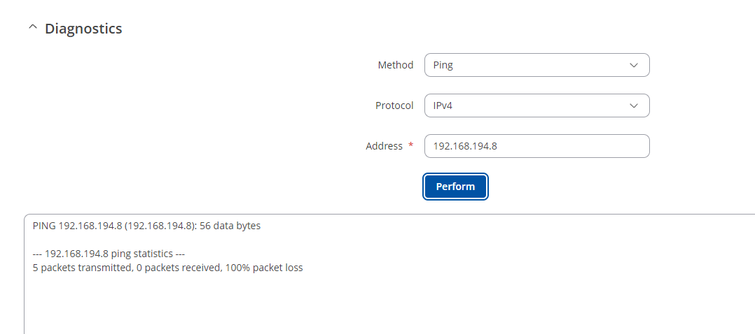

aaand… i cant ping them.
Can’t ping them both ways,the ping doesn’t work from the phone to the router or the other way.

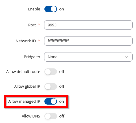

After reviewing your settings, it seems like you might have overlooked something. One setting should have been enabled by default. In the ZeroTier Network settings, the option “Allow managed IP” should be turned on, as shown in the picture below:
2024-03-04-14-27-25-RUTX12 - Teltonika Networks — Mozilla Firefox
Please adjust this setting and restart your router if the connection doesn’t establish.
Marijus
Correct!
Now it works, thank you Sir!
