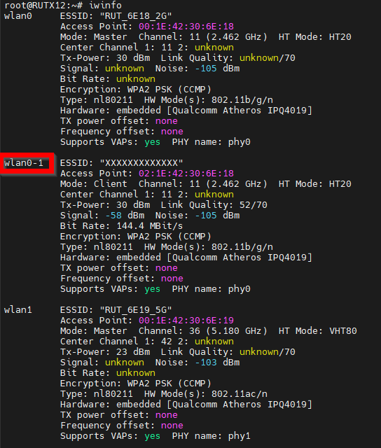

we are facing issues on command ‘iwinfo radio0 info’ on rutx10 firmware RUTX_R_00.07.07.2
we are getting ssid as unknown even when connected to 2G previously on fw RUTX_R_00.07.06.10 we didn’t face this problem.
You can use different commands to check the information of the Access Point (AP) you are connected to. The command you should use is iwinfo wlan0-1. To find out the name of the AP, you can use the iwinfo command.
