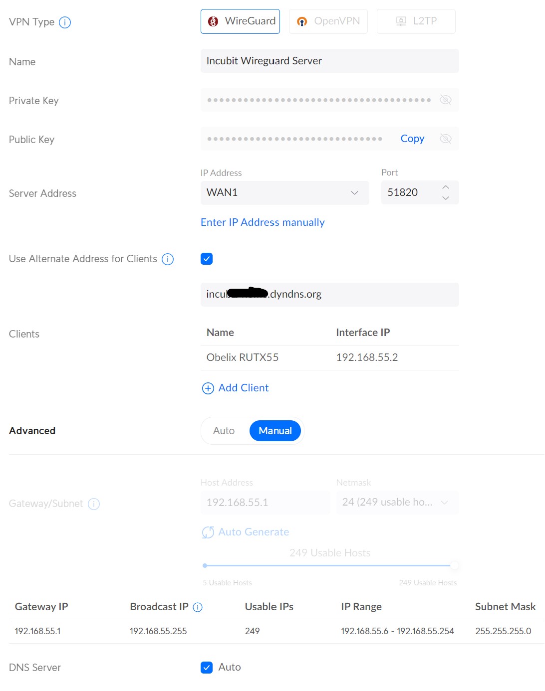

Hello everyone, I would like to set up a Wireguard VPN connection between a Teltonika RUTX50 and a Unifi Dream Machine (Pro).
The RUTX50 should act as a client and the Dream Machine as a server.
Unfortunately, I don’t understand the configuration of the RUTX50 Wireguard VPN correctly and I need help with which data I have to enter here and where so that the RUTX50 establishes the connection to the Dream Machine.
my current config on the UDM:
Since I am a new user in this forum, unfortunately I can only attach a single screenshot.
Thank you so much for your help and best regards
Benedikt
