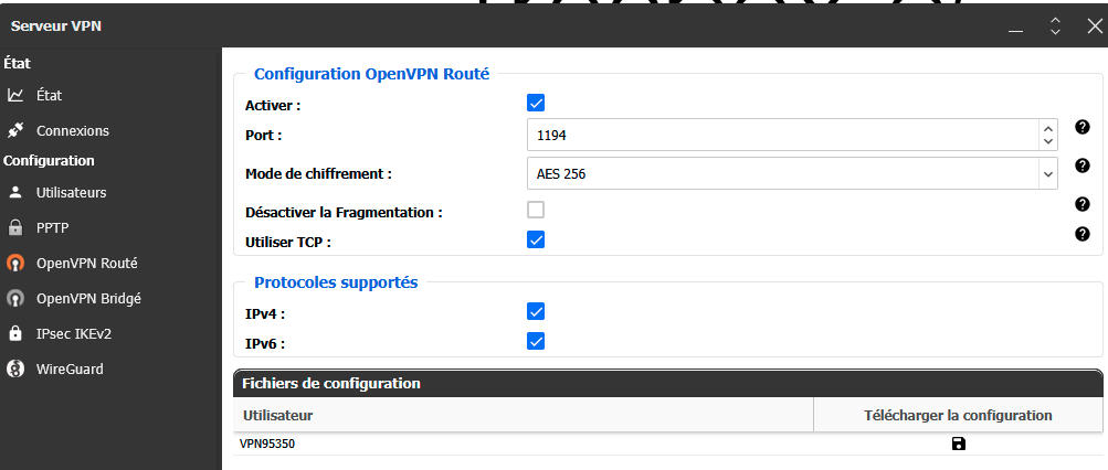

As mentionned previously, I tried different VPN protocols between my Freebox or Synology server (both Server side) and my RUT241 (client side).
Before the wireguard protocol, I have tried OpenVPN in tunnel mode server is in the Freebox and the RUT in client mode and as I am I hope near to make it works, I prefer that you help me on that config first.
I got the config openVPN from the Server and load it into the client.
The first problem was the information that no CA certificat was found. I modified the config on the RUT side and provide the 3 certificats keys by individual files.
Now the link certification phase works, but the tunnel collapse after some seconds and the process repeat and repeat…
The Freebox indicate that the client is authentified and the tunnel open but for some seconds with little few traffic.
The RUT 241 use an non public address and is is able to connect to internet.
My Freebox has a public domain name and a public IPV4 address which is rechable

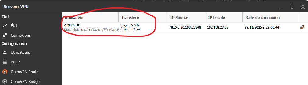

It repeat the same every 11 seconds
On the Freebox interface I can see the client knoking on the door
The config on the server side
