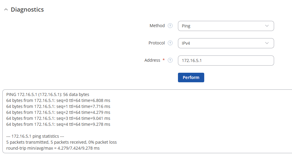

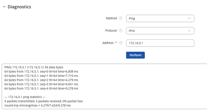

On the RUT, I can ping a device on the Juniper switch:
Capturing traffic on the Juniper, I see that is using the transit IP:

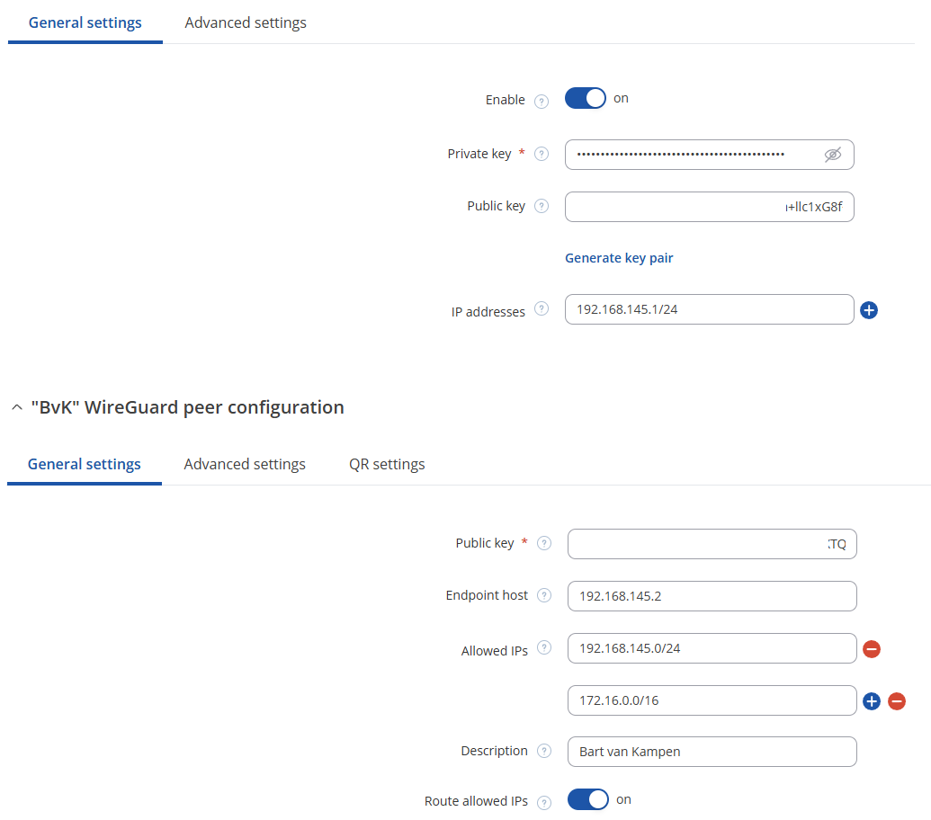

The subnet (172.16.5.0/24) is included in the “Allowd IPs” in the WireGuard section:

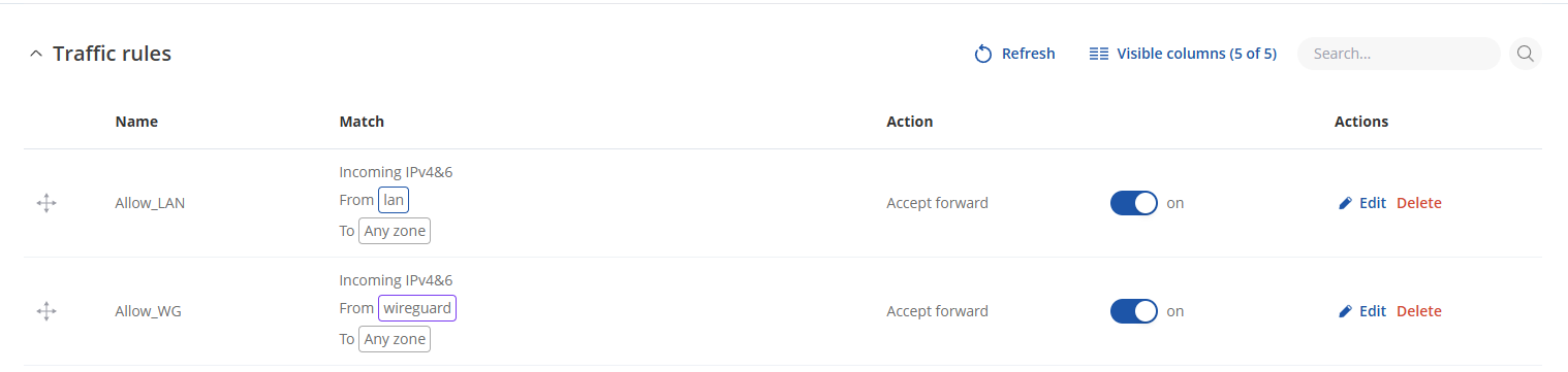

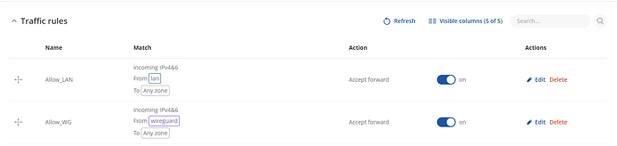

On the Traffic Rules I’ve already created a rule to allow all:

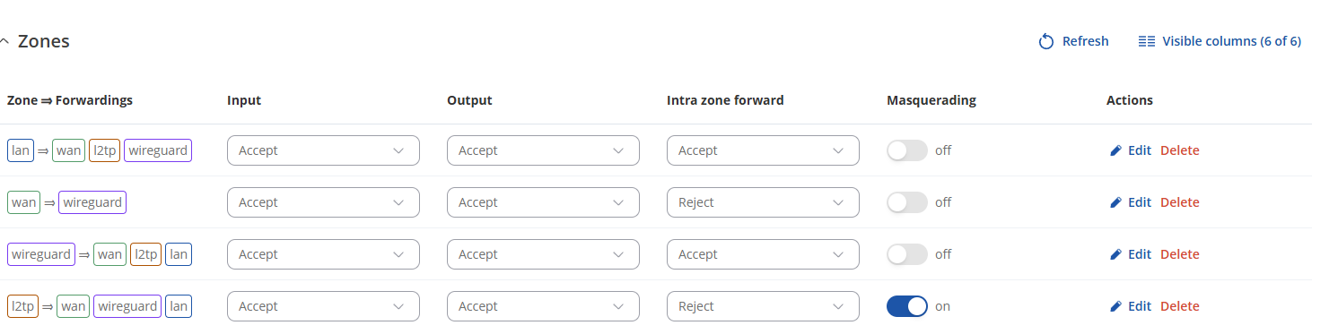

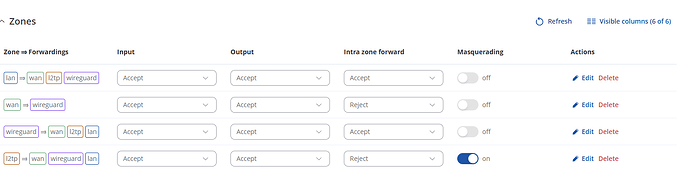

And on the Zones tab, allowd Wireguard to all:

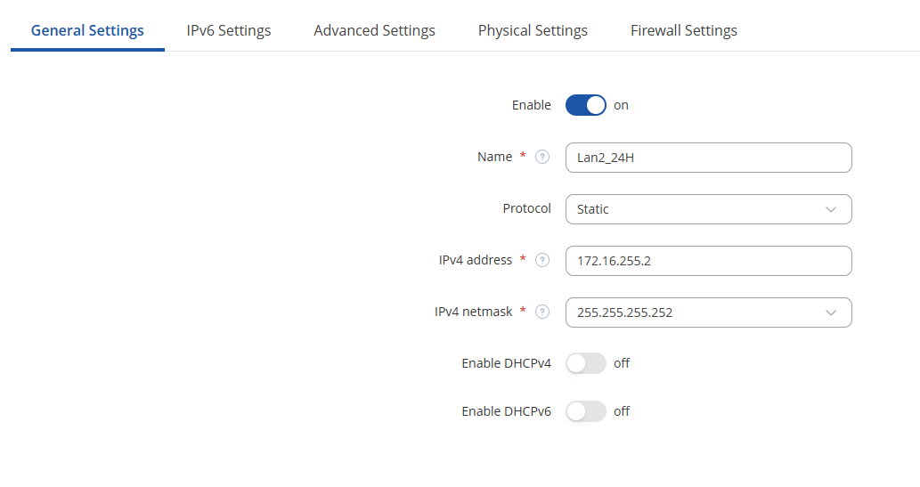

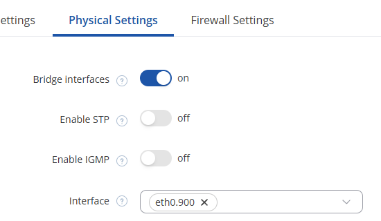

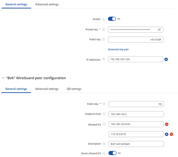

Added the interface tab:

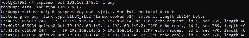

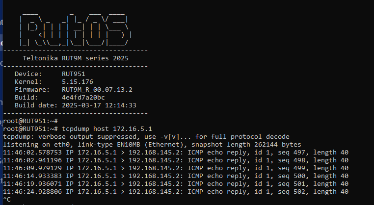

Just installed TCP dump on the box.
I see the ICMP Reply’s being received by the RUT.
So I guess it’s some filters?

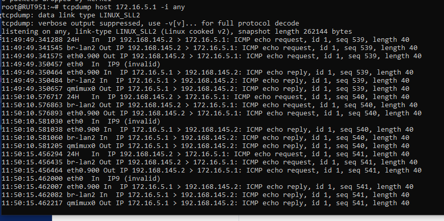

Here with -i any, to capture all interfaces:

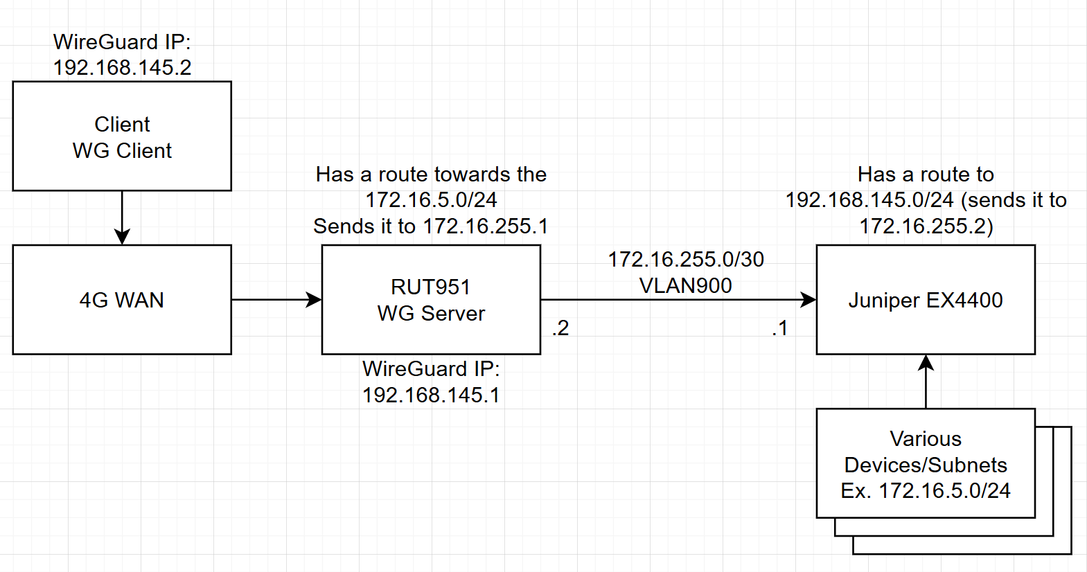

Your description isn’t that easy to follow, could you attach a drawing of your network with all addresses / netmasks ?
Where is the wireguard server ?
Tcpdump capture with -i any: the last visible output interface for the echo reply frame is qmimux0 !!! This looks strange.

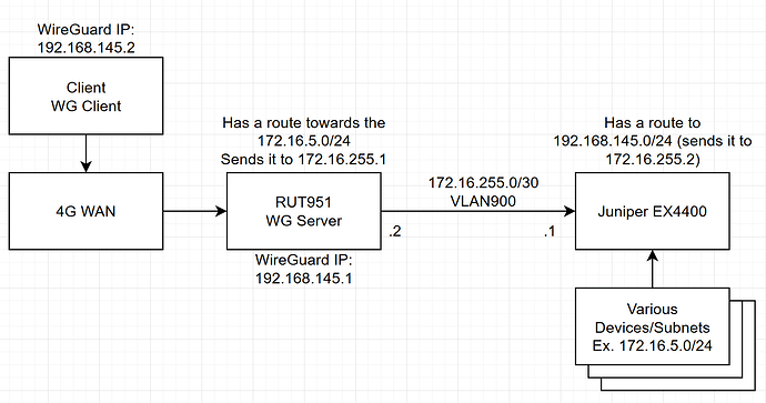

The WireGuards server is on the RUT itself.
See this drawing:
Even pinging the 192.168.145.1 isn’t working, also the last interface is the “qminux0”:
Your Allowed IPs field on the RUT is wrong it should contain 192.168.145.2/32 not 192.168.145.0/24.
That worked :slight_smile:
