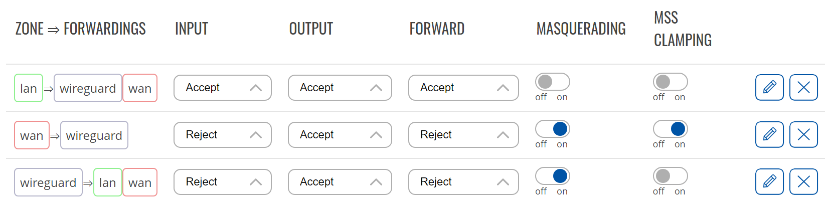

Firewall arrangement according to wiki pages I found:

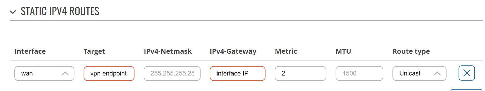

In the Network->Routing menu I find the static route settings but I am unsure what to put where to get the definitions, route and priority right. Is this it?
(inserting interface as gateway - otherwise it seems to me routing will be straight to the provider server and bypass the wg interface in the router?)
After save & apply this does not come up under status->routes and my provider says I am not using the tunnel regardless of whether I insert the interface or not.
Sorry to be daft in the eyes of the experienced, but I really haven’t had to deal with the mechanics of internet & routing before.
You don’t need to set the IPv4 Gateway field, just clear it. The interface is enough.

Be sure to have the correct Target field value.
I didn’t check carefully before but your firewall settings are pretty restrictive, set wan=>wireguard and wireguard=>wan to Accept/Accept/Accept at least for testing.
The IPv4 Gateway field is clear and the firewall settings are loose for testing, but no luck.
