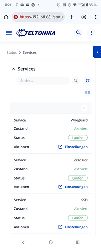

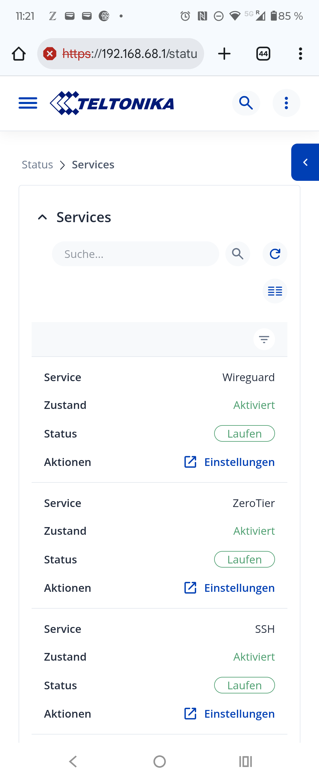

The Router tells my that wireguard
is running but if I test the IP I get the same Vodafone IP than before. If I do the same with a Goldenorb Router I get an IP of surfshark. Is it nessesary to change something in the Firewall?

Apologies for the delayed response. Could you please confirm if the issue with the WireGuard tunnel setup using the Surfshark WireGuard hub is still present or was resolved?
If it is, kindly share screenshots of the WireGuard configuration from the RUTM itself.
