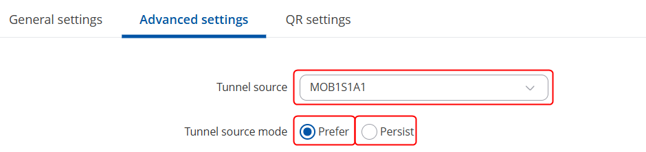

Apologies for a delayed response. Could you try selecting Tunnel source to mob1s1a1 (prefer/persist) in WG peer’s advanced settings?
This way, the WireGuard tunnel with the client should remain active during a wired WAN loss and continue running through the mobile WAN interface.

But this Advanced setting cannot be used on the “server” side, because this option requires the “General settings” to specify the “Endpoint host” address, which I don’t know and may be different each time.
