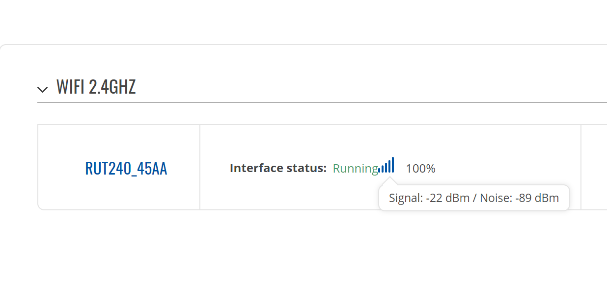

Does exist a solution to retrieve via an ssh (or other) command the signal and noise level of a WiFi connection as displayed on this page?
The idea is to be able to continuously monitor network variations to check the quality of the WiFi connection over time.

Thanks for reaching us.
Kindly can you try this command out.
iwinfo wlan0 info
