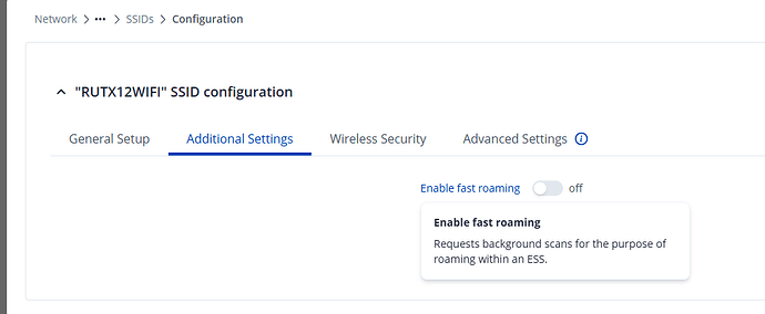

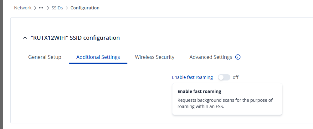

You may try enabling Fast Roaming under the additional settings (see screenshot below).

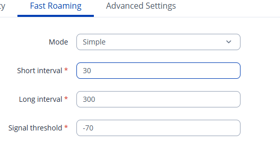

After enabling it, test different Fast Roaming configurations (simple mode, learning mode) and check whether this improves performance.

Thanks for the feedback! in our case fast roaming is disabled on the Wifi network as this network is based on MAC address authentication, so fast roaming will not make a difference from the netwrok side, do you see enabling it on Teltonika router will make a difference in Teltonika? Also in our case we do not use the stock antenna.
