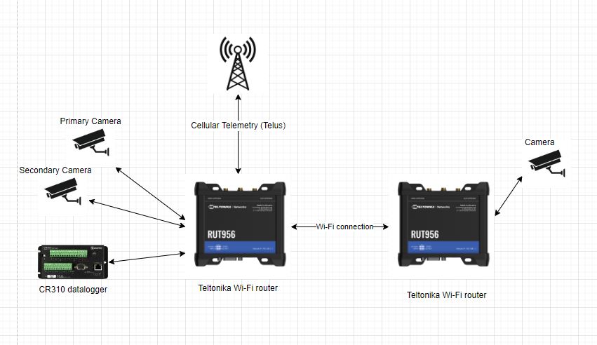

I have configured a wifi bridge connection to allow for internet connectivity to a remote modem and camera. The network diagram looks like this:

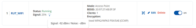

The wifi bridge does work, however the signal strength is not great enough to retrieve the images off the camera. I am looking for advise on how to improve this wifi bridge.

We will try to lock the band to see if that improves the connection. We are able to connect to the primary RUT956 reliably with the cell connection. We are not able to reliably connect to the secondary RUT956 reliably over the wifi bridge, although we can sometimes ssh into it.
