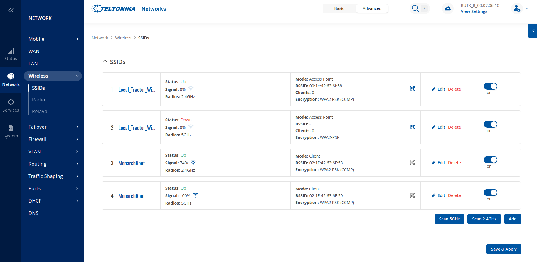

Problem:
we are configuring router with wifi access point and wifi client as ON but just after the router reboot the wifi access point(can be 2g or 5g) is showing down and we are not able to detect it in nearby devices, this is happening every single time, but once we turn off and turn on that access point than it is showing up again.
screenshot of the issue
The issue you are experiencing most likely is due to the configuration of two WiFi clients on both bands simultaneously. Please note that only one radio should be selected to operate as a client.
Additionally, I strongly recommend upgrading your RUTX11 RutOS firmware to the latest version, RUTX_R_00.07.12, as numerous improvements and fixes have been implemented since version 7.06.10.
If you require any further assistance, feel free to reach out.
will we be facing same issue(what i described above) with fw 7.03.3 also, because we are using it in some of our products and did not observed this issue.
