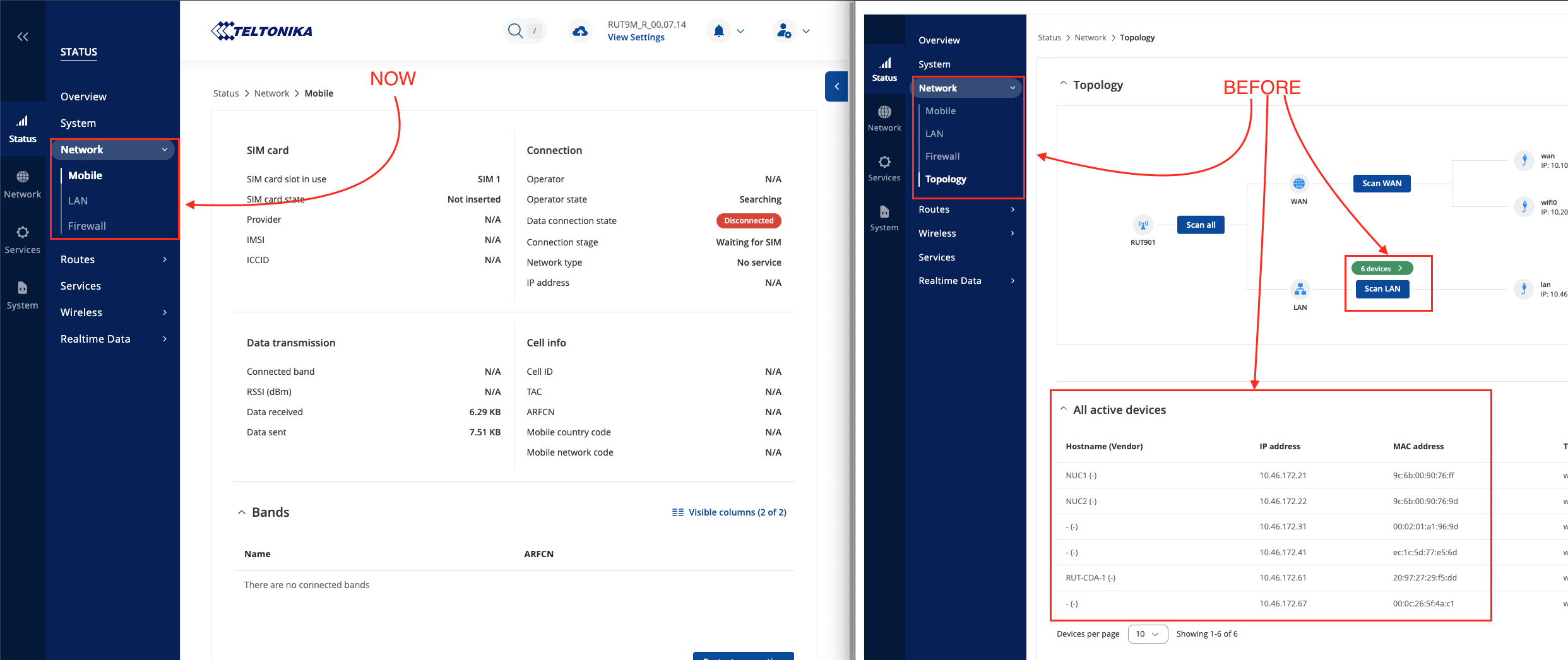

After updating to the newer firmware, the Network > Topology option is apparently not available.
RUT9M_R_00.07.14
RUT901
Where can I find the option? As it was very useful.
RUT9M_R_00.07.14
RUT901
Hi, check package manager, it has been moved from core package to installable in 7.13 firmware version.
Thanks a lot pwsh
It did not occur to me that it would now be on a package. Installed. Thank you
