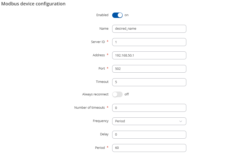

  1. Set Up Modbus TCP Client
  • Navigate to Services → Modbus → Modbus TCP Client.
  • Add a new Modbus device.
  • In the configuration window:
    • Specify a Name for the device.
    • Set the Modbus Server Device Address to your RUTX10’s LAN IP.
    • If prefered leave other options at their default values.

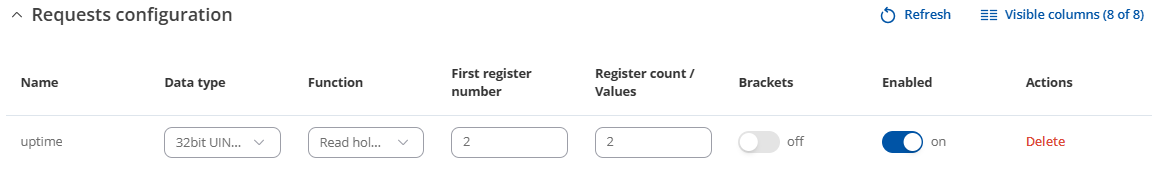

  1. Configure Modbus Request
  • In the same configuration window, scroll down to the Request Configuration section.
  • Add a new request:
    • Name: uptime (or any preferred name).
    • Data Type: 32-bit UINT.
    • Function: Read holding registers (3).
    • First Register Number: 2.
    • Register Count: 2.
    • Enable the request.
  • Test the configuration using the Request Configuration Testing section by clicking the test icon.

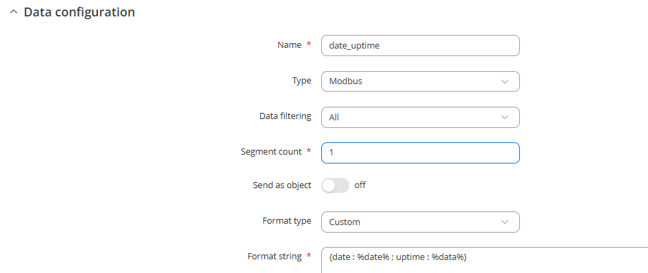

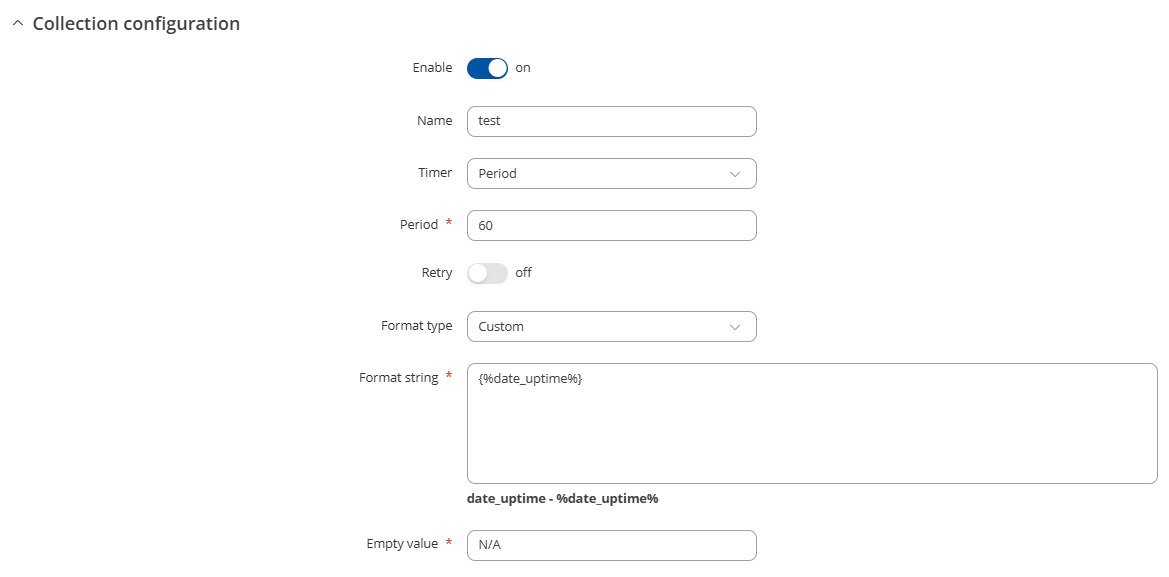

  1. Configure Data to Server
  • Navigate to Services → Data to Server.
  • Add a new instance by entering a collection name and clicking Add.
  • In the Data Configuration window:
  1. Collection and Server Configuration

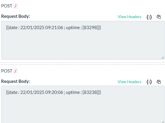

As a result, you should receive uptime data with a timestamp to your cloud server periodically (every minute):
