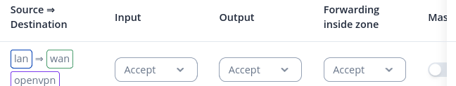

it’s firewall day today. I have been doing Linux firewalling since 1998, and I am having a hard time to map Teltonika’s terminology in “my world’s” terminology.
For example, I have switched the “masquerading” switch on my lan => wan zone rule off:
and would expect my Internet access to stop working with this setting. However, even after rebooting the router (to get rid of any connection tracking table entries that might still reflect thw own setting), my Internet still works.
What did I actually change by switching off the Masquerade switch? I expected that to remove a rule in the POSTROUTING rule, that would pronbably say –in-int lan –out-int wan –jump MASQUERADE, but it looks like my router still does source NAT.
Where does this originate?
How can I set source NAT for lan => wan traffic and no source NAT for lan => openvpn traffic? It looks like this part of WebUI doesn’t allow me to define a second rule with lan as the source.

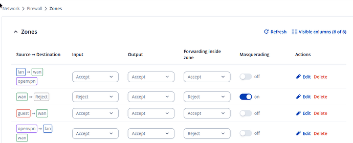

Never mind, this issue can be closed. Thank you for providing unrestricted ssh access so that the expert user could figure out for myself.
The solution to my question is:
Setting of the “Masquerading” option in the Network/Firewall/Zones settings influences packets going OUT of the Interface that is listed as SOURCE in the respective line:
In this case, a MASQUERADING rule is inserted in the zone_wan_postrouting chain which is called from the POSTROUTING chain for packets tht have eth1 (my WAN interface) as OUTGOING interface:
Chain POSTROUTING (policy ACCEPT 5 packets, 292 bytes)  pkts bytes target     prot opt in     out     source               destination    25  2763 postrouting_rule  all  --  *      *       0.0.0.0/0            0.0.0.0/0            /* !fw3: Custom postrouting rule chain */     1    52 zone_lan_postrouting  all  --  *      br-lan  0.0.0.0/0            0.0.0.0/0            /* !fw3 */    20  2471 zone_wan_postrouting  all  --  *      eth1    0.0.0.0/0            0.0.0.0/0            /* !fw3 */     0     0 zone_guest_postrouting  all  --  *      br-lan1  0.0.0.0/0            0.0.0.0/0            /* !fw3 */     0     0 zone_openvpn_postrouting  all  --  *      tun_+   0.0.0.0/0            0.0.0.0/0            /* !fw3 */     0     0 zone_openvpn_postrouting  all  --  *      tap_+   0.0.0.0/0            0.0.0.0/0            /* !fw3 */
Chain zone_wan_postrouting (1 references)  pkts bytes target     prot opt in     out     source               destination    20  2471 postrouting_wan_rule  all  --  *      *       0.0.0.0/0            0.0.0.0/0            /* !fw3: Custom wan postrouting rule chain */    20  2471 MASQUERADE  all  --  *      *       0.0.0.0/0            0.0.0.0/0            /* !fw3 */
Turning the option on on the LAN interface makes an identical rule appear in the zone_lan_postrouting chain:
This is somewhat counterintuitive and can only be figured out by people like me who’ve been having complex iptables expressions for breakfast for two decades. For normal users, this needs to be explained in the docs.
