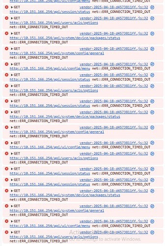

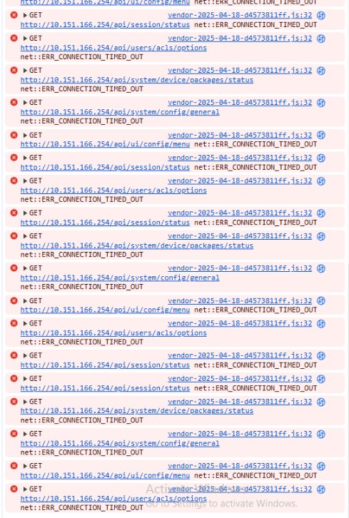

I saw that I had quite a few connection errors.
I think, I have a problem of firewall, because in local mode no problem.
Is there a way to see firewall log?
