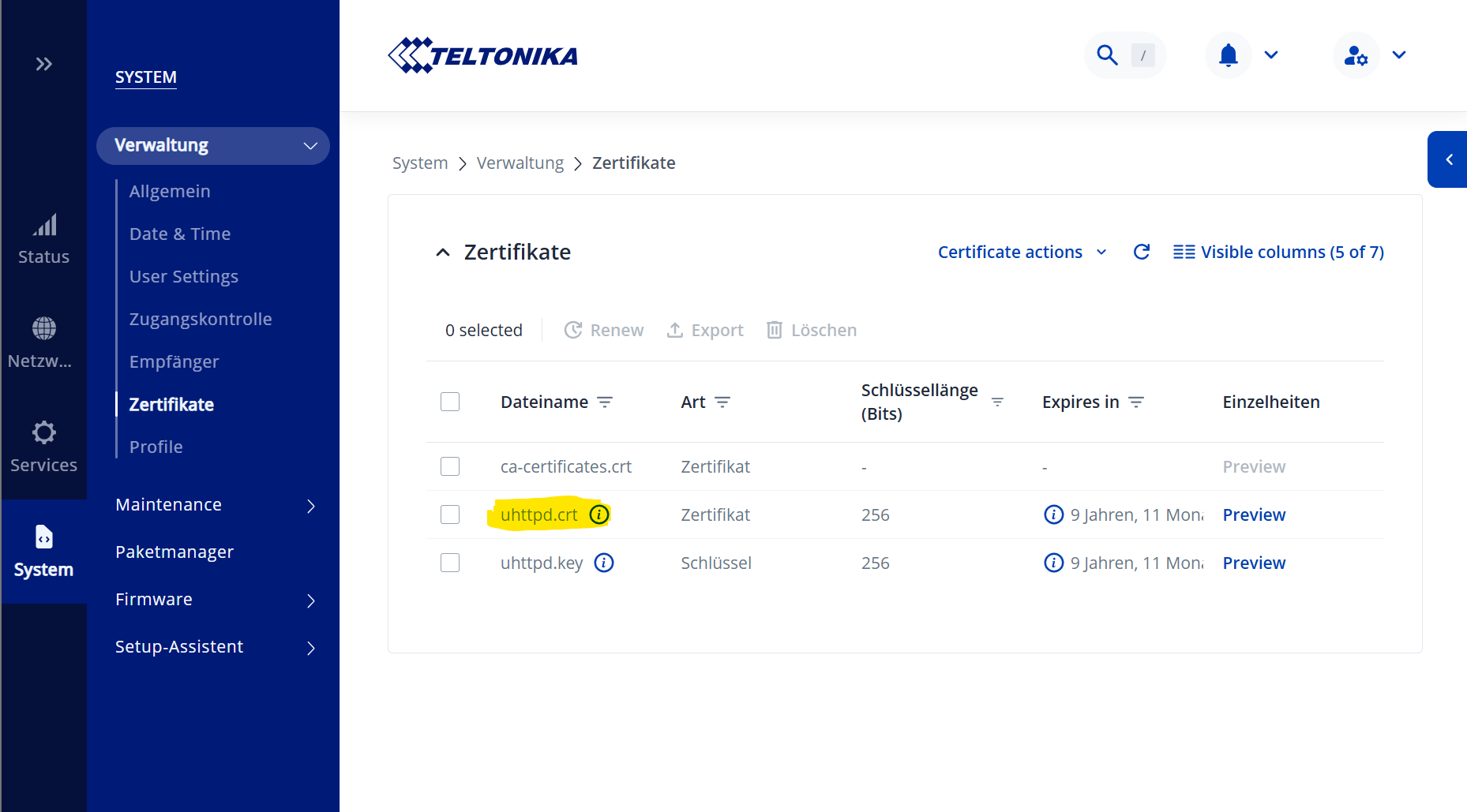

Go to System → Zertifikate → tick in the box and export to download the uhttpd.crt to your computer as *crt file.
