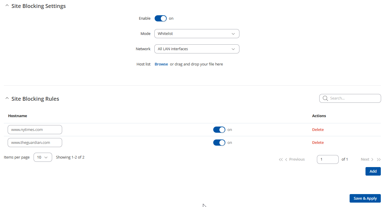

I tested the Web Filter service, and it’s working well. Just a quick note: make sure that text lines in the .txt file are separated by line breaks for proper functionality.
After uploading the .txt file, websites should appear in the “Site Blocking Rules” section, similar to the picture below.

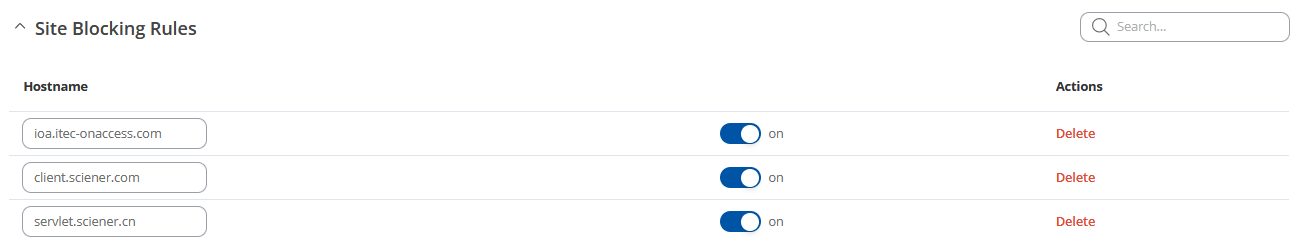

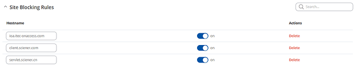

I mentioned there’s an additional service issue. When you connect to ioa.itec-onaccess.com, it also attempts to reach two additional addresses: client.sciener.com and servlet.sciener.cn.
Rules window to Whitelist your desired address should look like this:
The symbol “-” is not the problem, and addresses with this symbol should and are functioning correctly.
Marijus
Thank you, it did work!! Can I ask you how you get those other urls?
