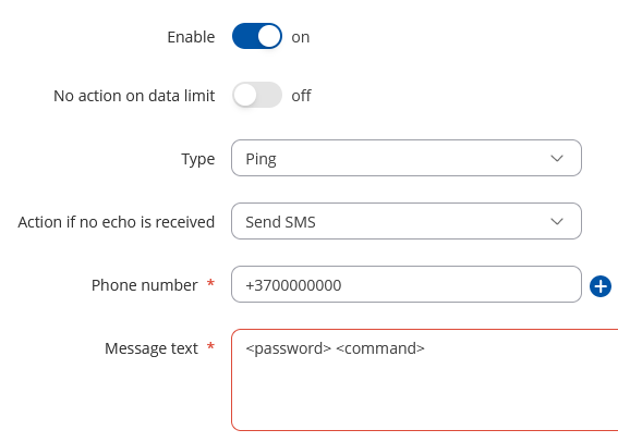

This explanation clarified things. Yes, it’s possible, and the cleanest way to do it would be through a script that adjusts the output value if a ping to a specific host fails to reach its destination.
Since you mentioned using SMS to trigger this event, there’s a slightly messy but quick workaround. You can set up a Ping/Wget reboot to send an SMS to the router itself if pings don’t reach the destination. This can be configured via the web interface and should be pretty straightforward.
This is an example of the configuration should look:
2024-04-15-15-47-37-RUTX50 - Teltonika Networks — Mozilla Firefox
