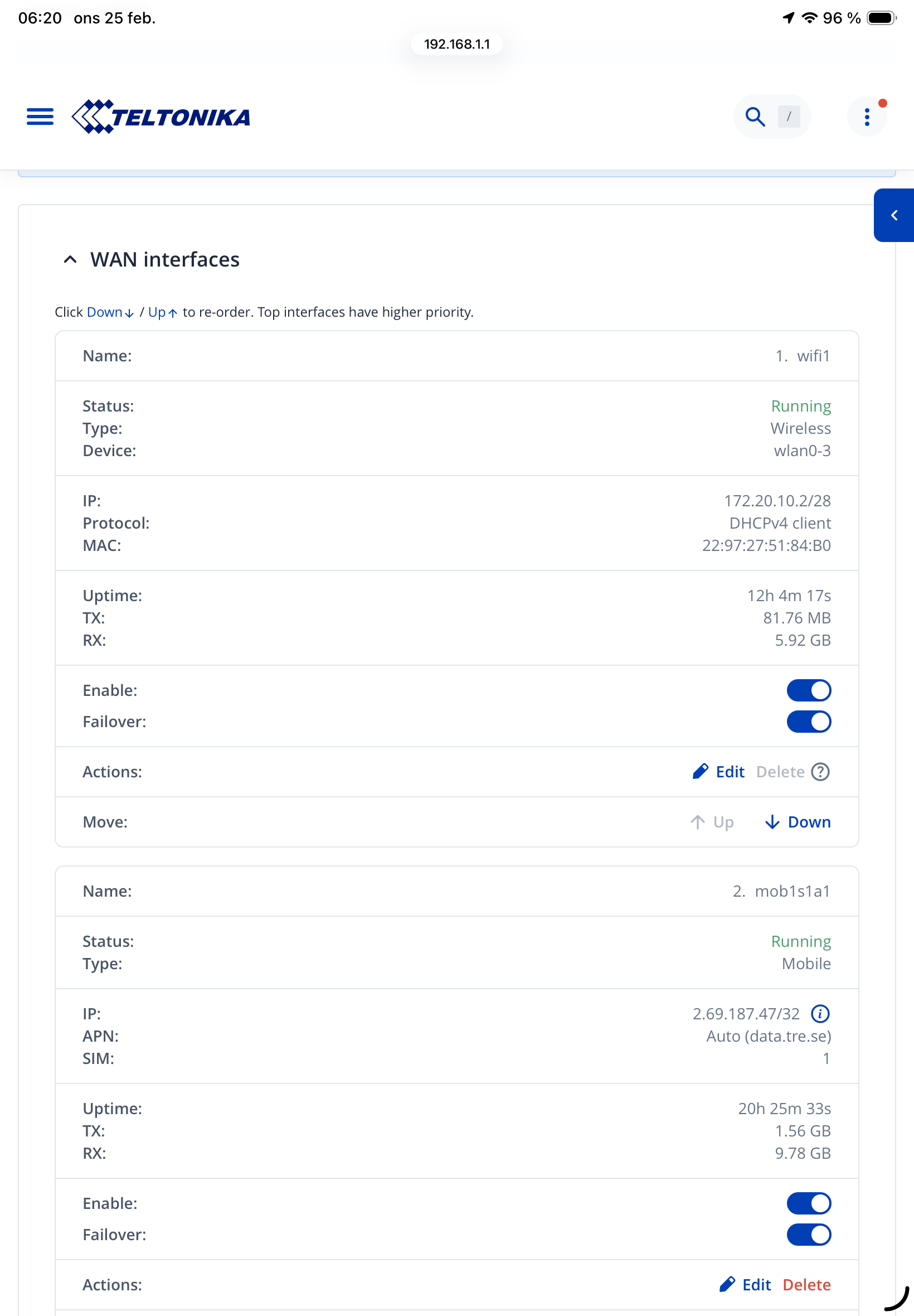

WAN priority confusing
How come that RX on the second source is active? I thought that priority should be on source one as long as its up n running.
Source two is the SIM in the router.

This is usually due to the fact that the SIM card must send (and receive) a small amount of data to the operator in order to stay up.
