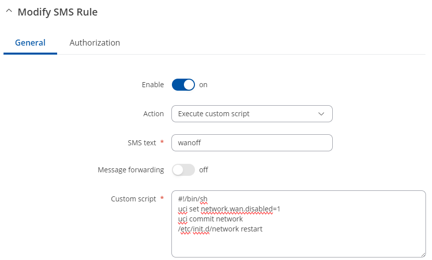

As for the commands to be executed in one message, I would highly recommend making a custom text command.
You can do so by going to Services → Mobile Utilities → SMS Utilities → Add rule with your desired SMS text and action “Execute custom script”. It should look something like this:

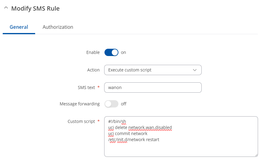

And add another rule for turning on the wan. It should look something like this:
Let me know how it goes for you,
