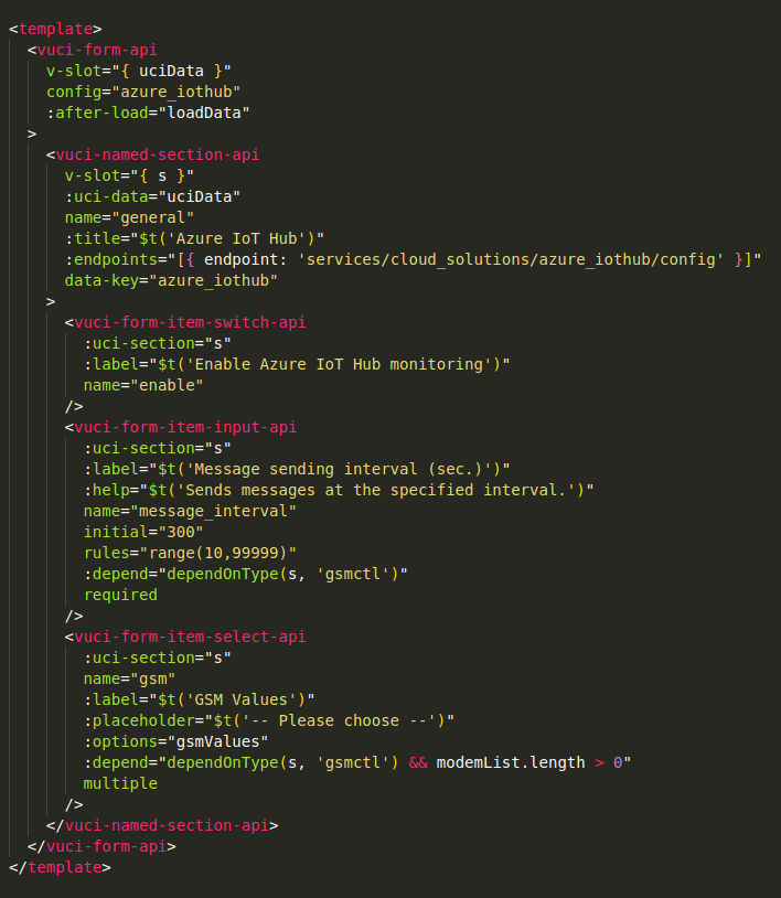

Example .vue file structure
vuci-form-api
Props:
  • v-slot and uciData: loads all form data from the application’s configuration.
  • config: specifies which configurations the application supports.
  • after-load: optional, loads additional data from the device when not enough information is available from uciData.
vuci-named-section-api
Props:
  • v-slot and s: loads section information.
  • :uci-data: object that stores all page configurations by data-key.
  • name: UCI section name, can be found in configuration.
  • title: application title / name.
  • endpoints: specifies the endpoint used in this section (must be unique to this section).
  • data-key: key that stores section information in the uci-data object.
Inputs
Commonly used inputs: vuci-item-switch-api, vuci-item-input-api, vuci-item-select-api.
Global props:
  • uci-section and s: configurable section object.
  • label: input label.
  • help: input hint.
  • name: input name.
Input props:
  • placeholder: input placeholder.
  • rules: input validation rules.
  • initial: default value if nothing is specified in the config.
  • depend: option to make one input dependent on another (often used to hide/show inputs dynamically).
Select input props:
  • options: select input options (equivalent to <option></option>).
  • multiple: allows multiple selections.
