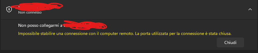

  • “A Connection to the remote computer could not be established, so the port used for this connection was closed.” error.
    Can’t see the user trying to connect from the logs.

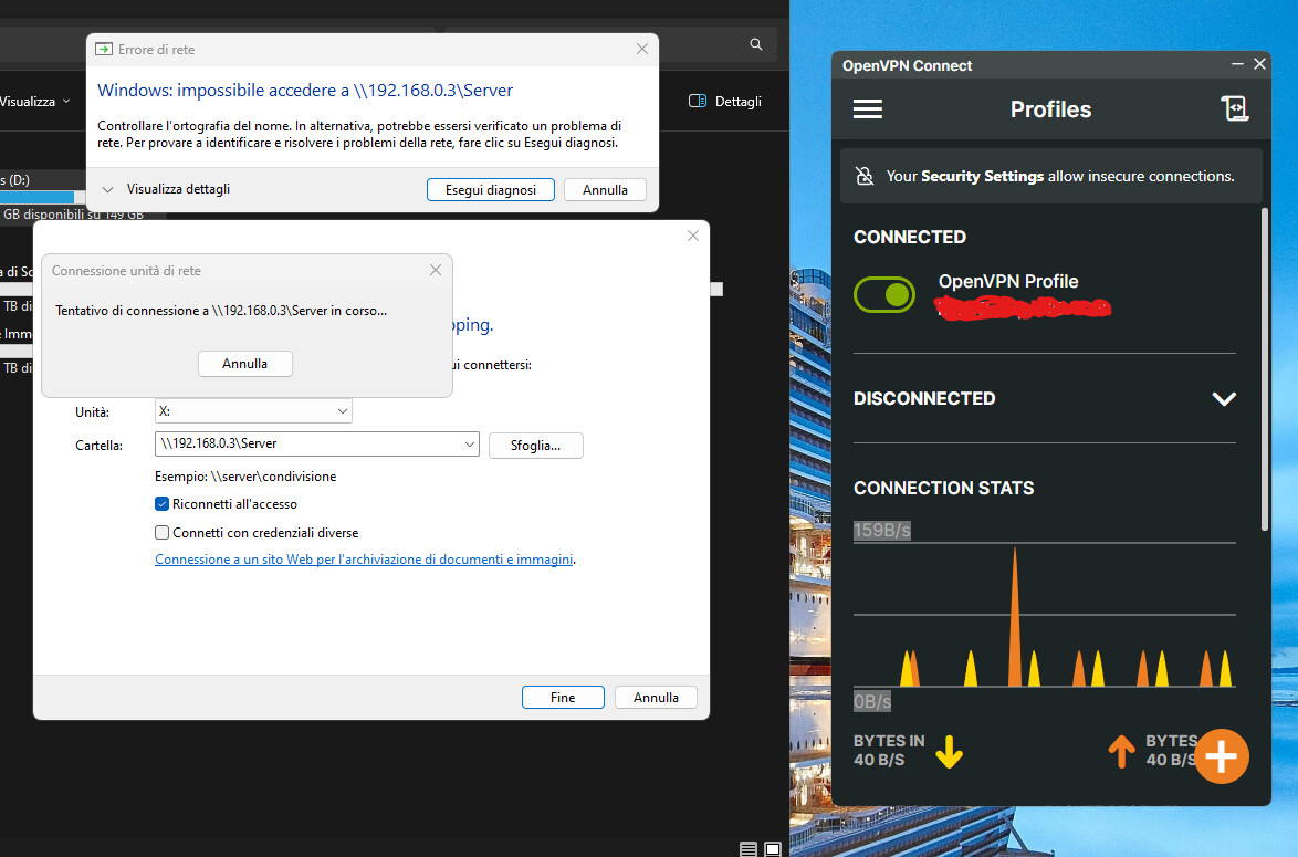

  • Can connect, but when I try to add the network drive windows cant see the server (on 192.168.0.3). From the server webinterface I can see the user connected, but the user can’t reach the samba.
Of course user is enabled for vpn (both types), user is not banned, username and pw are correct. The user can create the samba connection if is the office (LAN).

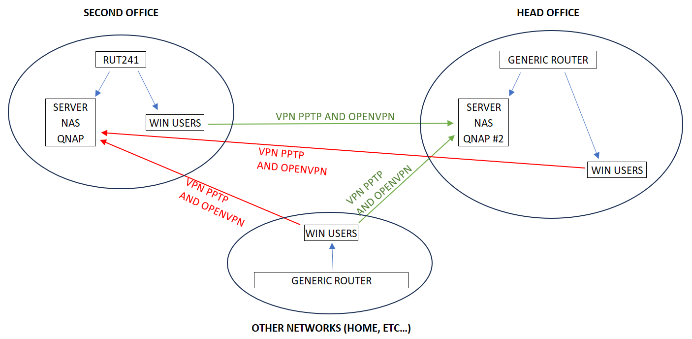

But I cant reach the server while connected from an another network with a VPN (tried both with PPTP and OpenVPN, with different results as described above.
Below a chart. RED not working, GREEN working.

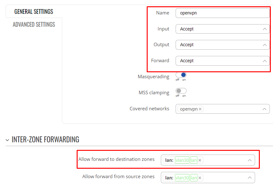

Please check firewall on RUT241. In Network → Firewall → Edit PPTP and OpenVPN zone - allow Input/Output/Forward, and put LAN to ‘allow forward to destination zones’.
Let me know if this helps.
I dont have “LAN30”, plus the PPTP and OpenVPN are hosted directly from the server at 192.168.0.3.

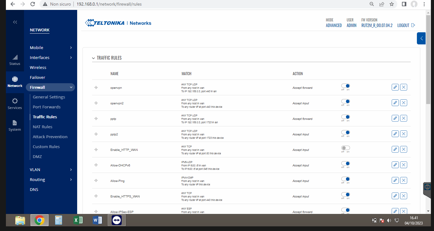

this is the traffic rule for the pptp. still not working. Something wrong?
PS. Now removing the port forward the pptp says cant connect to the vpn server and the openvpn cant connect at all.

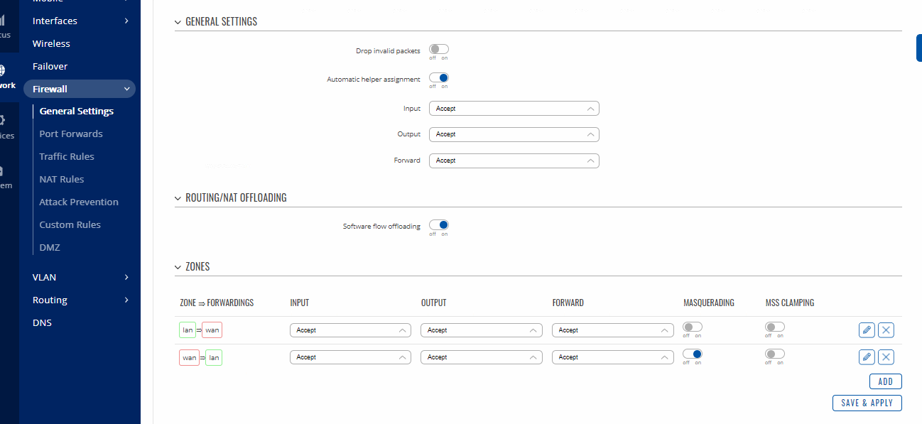

Network → Firewall → Automatic helper assignement should be turned ON. (Alternatively, disabled it, edit WAN zone → advanced settings → Conntrack helpers - PPTP VPN.)
If there are still issues, navigate to Network → Interfaces and make sure Mob1s1a1 is at the top (main WAN). Also, you can edit the mob1s1a1 interface → Advanced settings and try lowering MTU. Values to try are 1460, 1360, 1260.

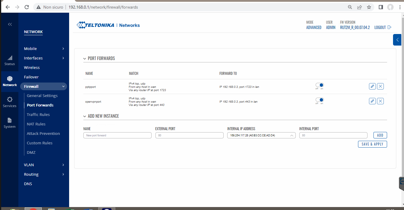

recreated the forward as below.

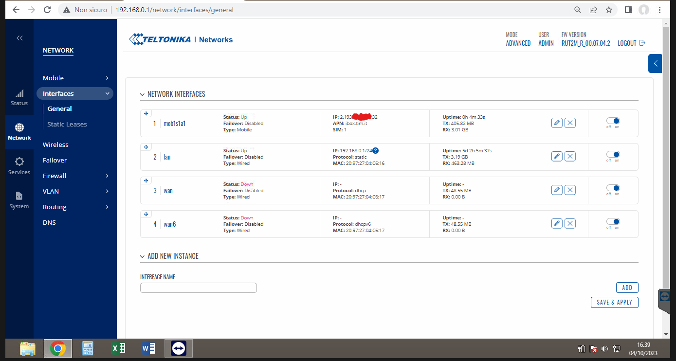

After that I have moved the mob1 to first place as below:
The Automatic H.A. is already ON, and i have added the lan to the destination for the wan zone, as below:
I still have the traffic rules from before as below:
For this point i have tried to disable openvpn and pptp rules, disable all 4, disable the openvpn2 and pptp2 rules and leave all 4 enabled. Still not working.

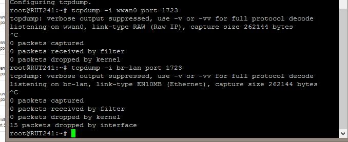

Below the output of the tcpdump:
ctrl+c after 1 min

PPTP: “A Connection to the remote computer could not be established, so the port used for this connection was closed.” error.
OPENVPN: * Can connect, but when I try to add the network drive windows cant see the server (on 192.168.0.3). From the server webinterface I can see the user connected, but the user can’t reach the samba.

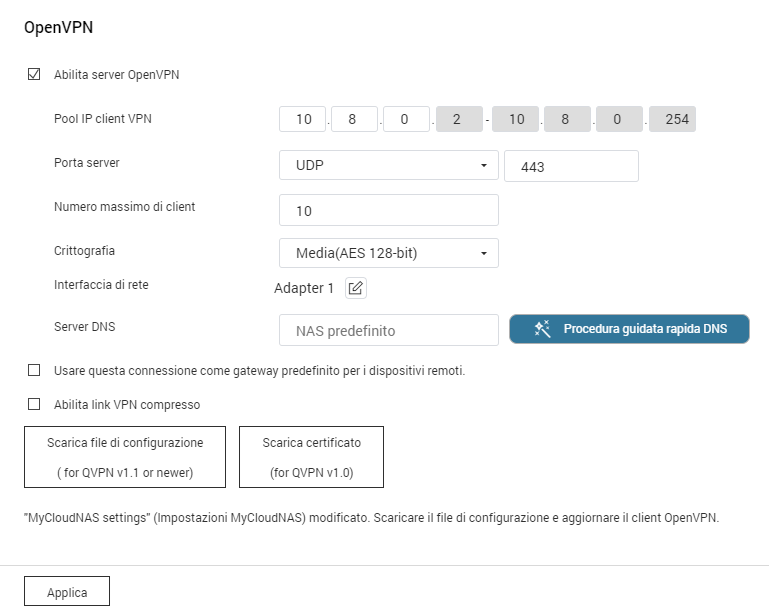

With OpenVPN you mention that you can connect, but unable to access SAMBA. Are you using hostnames for SAMBA and are those hostnames resolved? Is DNS configured for OpenVPN? Could you check if it works with IP addresses?
Hello, for the OpenVPN the qnap create a ovpn directly. Configurated with the DDNS (tried with direct ip too but no difference).
To add the SAMBA connection i just go to the “my computer” folder and press “add network drive”. As path i put " @\192.168.0.3\Server" (its the folder name. Remove @, i just needed to put because this site remove the double \ ).
For the pptp i already have checked the “accept ms-chapv2” option on windows.

Screen of the server OpenVPN vpn config:

If it helps, I can add that i have tried to create rules in the rut for the ftp too, enabled it, enabled the user, but still cant connect via filezilla, error “ECONNREFUSED”.
The error of PPTP, talking about a port closed:
The error of the SAMBA over OpenVPN:

Also, while I have not tried this (since GRE should be handled by conntrack), but you can try adding another port forwading rule where protocol is ‘custom’ and set to 47:
Then, check traffic with:
tcpdump -i br-lan 'port 1723 or proto 47'
First: Now that i added the gre forwarding (which i asked how to add) the pptp is correctly working, thank you.

About OpenVPN. Is the issue with SAMBA only? Are you able to ping or reach other devices in the OpenVPN network? Could you do a TCPDump for that too? You can check OpenVPN interface with ‘ifconfig’.
if I try to ping 192.168.0.3 after connecting with openvpn i get unreacheble:
Esecuzione di Ping 192.168.0.3 con 32 byte di dati:
Risposta da 192.168.0.100: Host di destinazione non raggiungibile.
Statistiche Ping per 192.168.0.3:
Pacchetti: Trasmessi = 4, Ricevuti = 4,
Persi = 0 (0% persi),
Kind regards

For the OpenVPN config here you are:
SERVER SIDE:
CLIENT SIDE:
sett1
sett2
sett3
sett4
I just removed the settings about theme
(From the screen you can see that i have set again 443 udp after the test with the 1194)
Kind Regards
From the configurations, I do not see any fields where you can specify networks/routes. Thus, could you check on your OpeVPN client machine if the route to 192.168.0.0/24 network is specified with OpenVPN interface? For example, if you are running Windows on the client, you can check routes from command line (CMD):

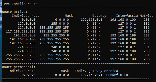

route print -4
Is there a route to 192.168.0.0/24 (or 192.168.0.3 server)?

meanwhile this is the route tab from my PC where i try to connect with OpenVPN.
Done with OpenVPN program turned off.
Kind Regards
First of all, the VPN needs to be enabled so that we can see what routes are added when VPN is enabled.
Secondly, I can see that there is already a route to 192.168.0.0/24 via 192.168.0.100 IP. It is likely that when you try to reach 192.168.0.3 SAMBA, the PC sends packets tot 192.168.0.100 instead of the VPN tunnel. As one of the options, you can change the network subnet on which this PC is connected to something different, like 192.168.10.0/24. If there are still issues, please post a screenshot with routes again, but with VPN enabled.
