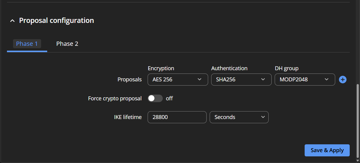

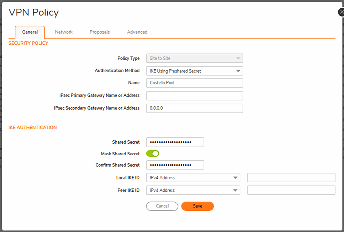

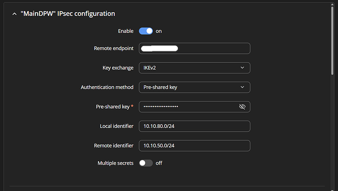

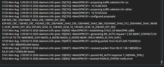

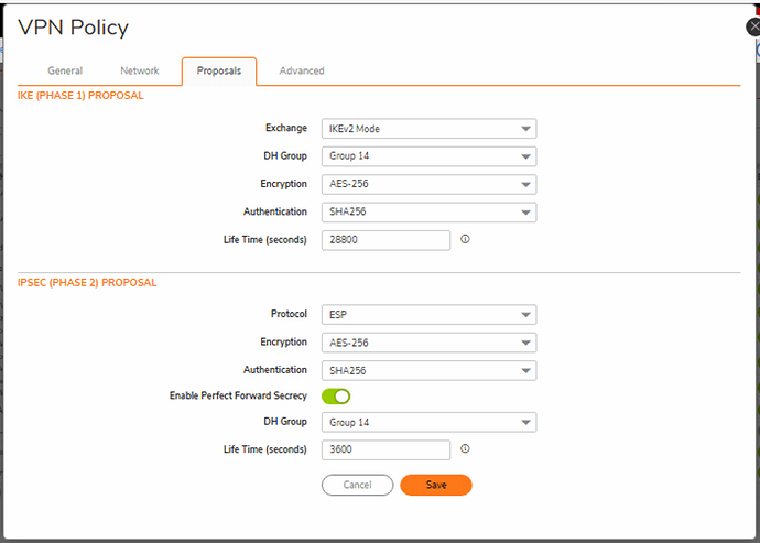

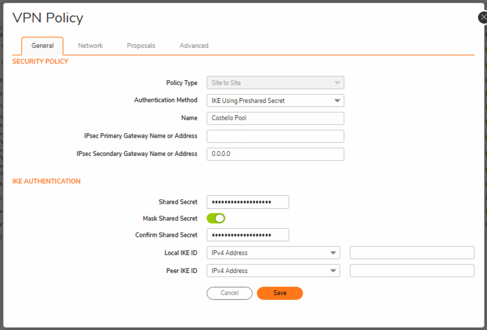

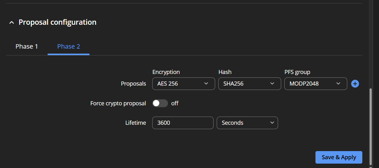

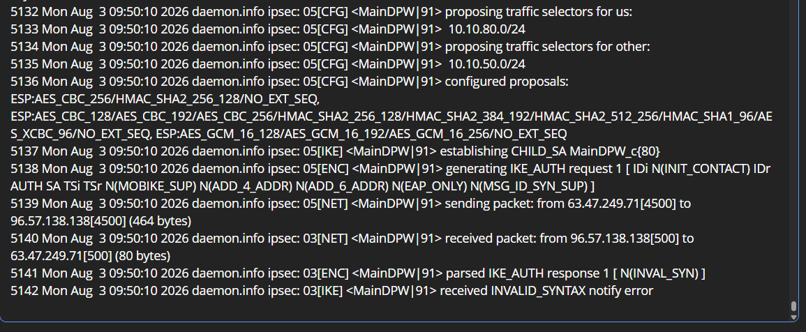

The setting for the vpn tunnel look the same. I spoke with William in tech support who informed me to post a topic here so i could upload images of the settings and see if anyone has run into this issue specifically between the RutM50 and Sonicwall TZ670. For clarity I have other cellular modules happily connected to the same sonic wall with the same settings as listed. Is there a setting I am missing here?
For troubleshooting purposes, we will require more sensitive information from your end, such as the troubleshoot file, which may contain passwords, public IP addresses, serial numbers, and such. To avoid leaking this information, we have sent you a form to fill out, which you will receive in your e-mail inbox that you have registered your account with in the forums. In the Ticket ID field of the form, please enter the ID of this thread, which is 20498.
