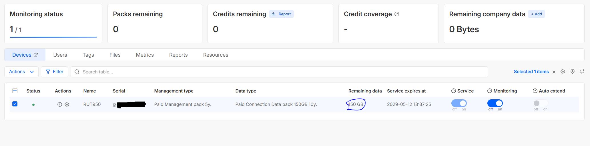

I bought the 150Gb 10year pack, applied to my device, but don’t know how to apply it further for my vpn to connect. I applied the pack to my only device. I have a valid RMS management pack applid to the device also.

As i can see this is the only device you have added, by default, if you set up the VPN hub via this device, it would be using the data from the resource pack assigned to the device, rather than resources from the main pool.
