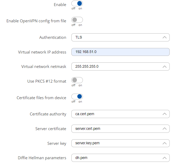

  2. For openVPN, with this config
    I get
Thanks!

Ok, I solved the saving issue. I mistakenly used the same IPv4/24 range of the router for the Virtual network IP address.
