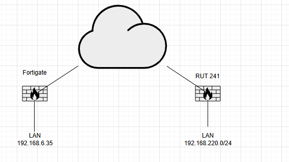

Hello we have a RUT 241 (7.17.1) with 4G sim connected via VPN IPSec to Fortigate running 7.4.8.
We have created an ikev2 tunnel and it’s up correctly, but it’s working on one way.
Scenario:
The tunnel is connecting as dialup
From the Teltonika’s LAN I can reach the LAN behind the fortigate but not viceversa. When I ping from 192.168.6.35 toward LAN 192.168.220.0/24 (I tried an host inside the LAN or the Teltonika itself) but I cannot see traffic.
In the fortigate sniffer I can see traffic entering the tunnel but tcpdump in the Teltonika is empty
Hello, additional information: We tried to enable/disable the local firewall and remote firewall on the Teltonika with all possible combinations, but with no luck. Additionally, we created a specific rule in the firewall with no result. Can someone please help us?

Hello, as per my first message, we have 7.17.1 on RUT.
The 4G SIM does not have a direct public ip address, but as it has internet access, it can initiate a dial-up IPsec with NAT. However, we solved the problem by expanding the remote subnet from 192.168.6.35/32 to a/24 subnet. Is it possible that the subnet length needs to be the same to work properly?
That’s right. The subnet length on both sides of an IPsec tunnel should match for the tunnel to work properly in both directions. If one side uses a /32 (host) and the other uses a broader subnet like /24, the mismatch can cause traffic flow issues. This is because the VPN device will only encrypt and route traffic matching the configured selectors. In your case, expanding the remote subnet from 192.168.6.35/32 to a /24 subnet fixed the problem because it aligned the traffic selectors on both ends, allowing all hosts in the subnet to be reached through the tunnel and traffic to flow both directions.
