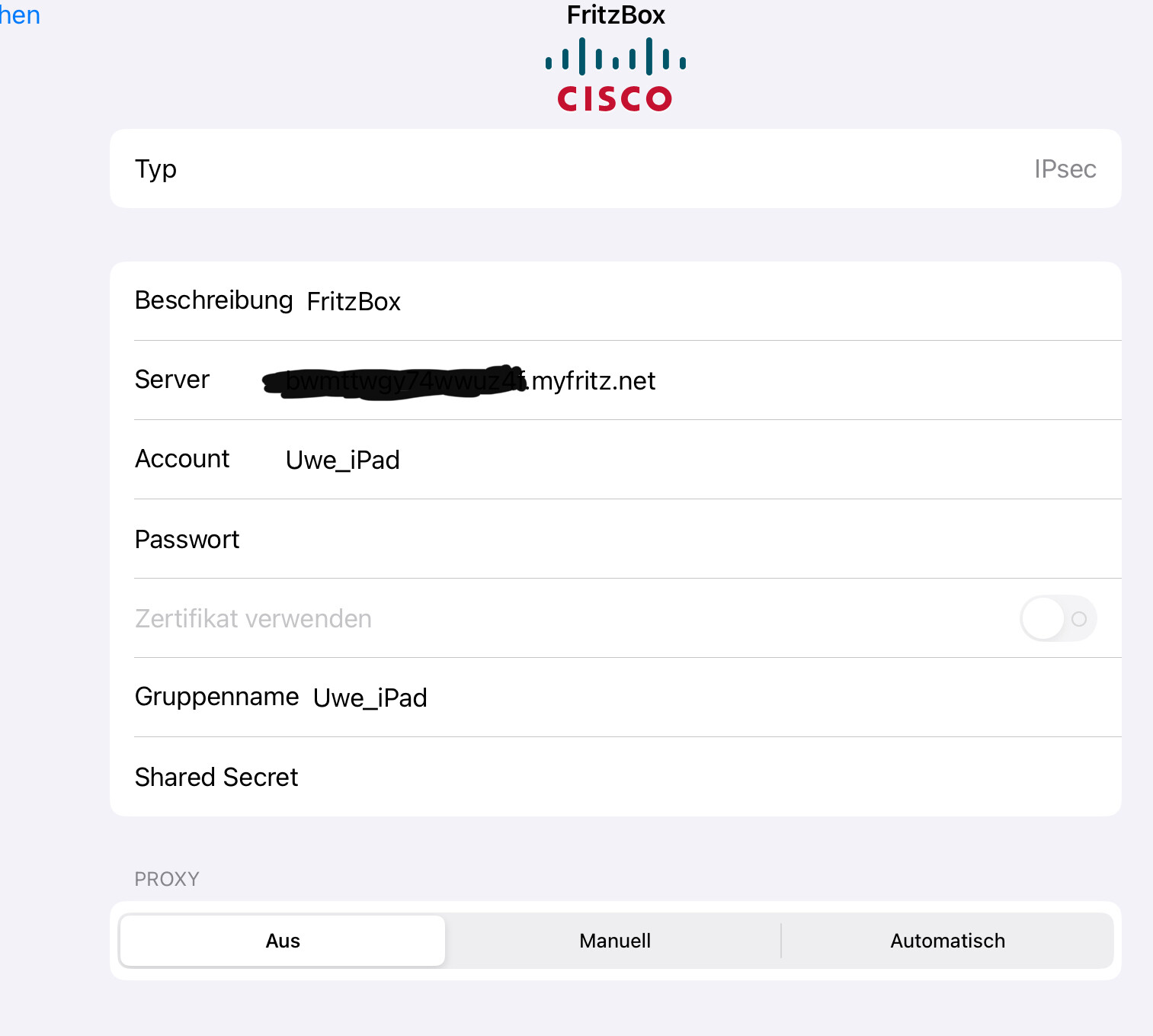

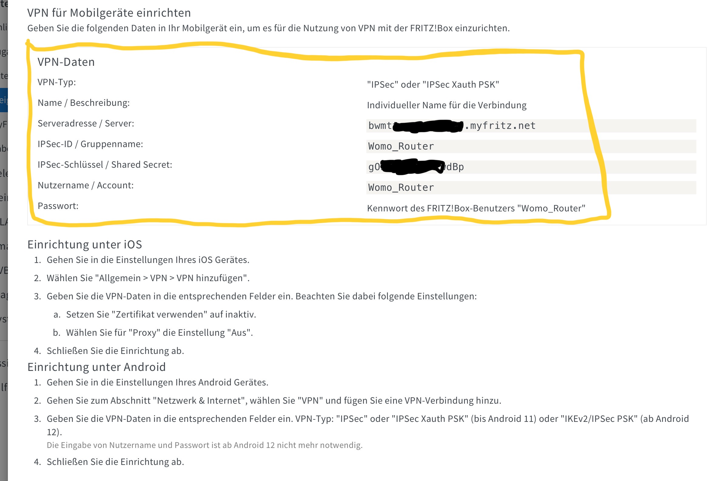

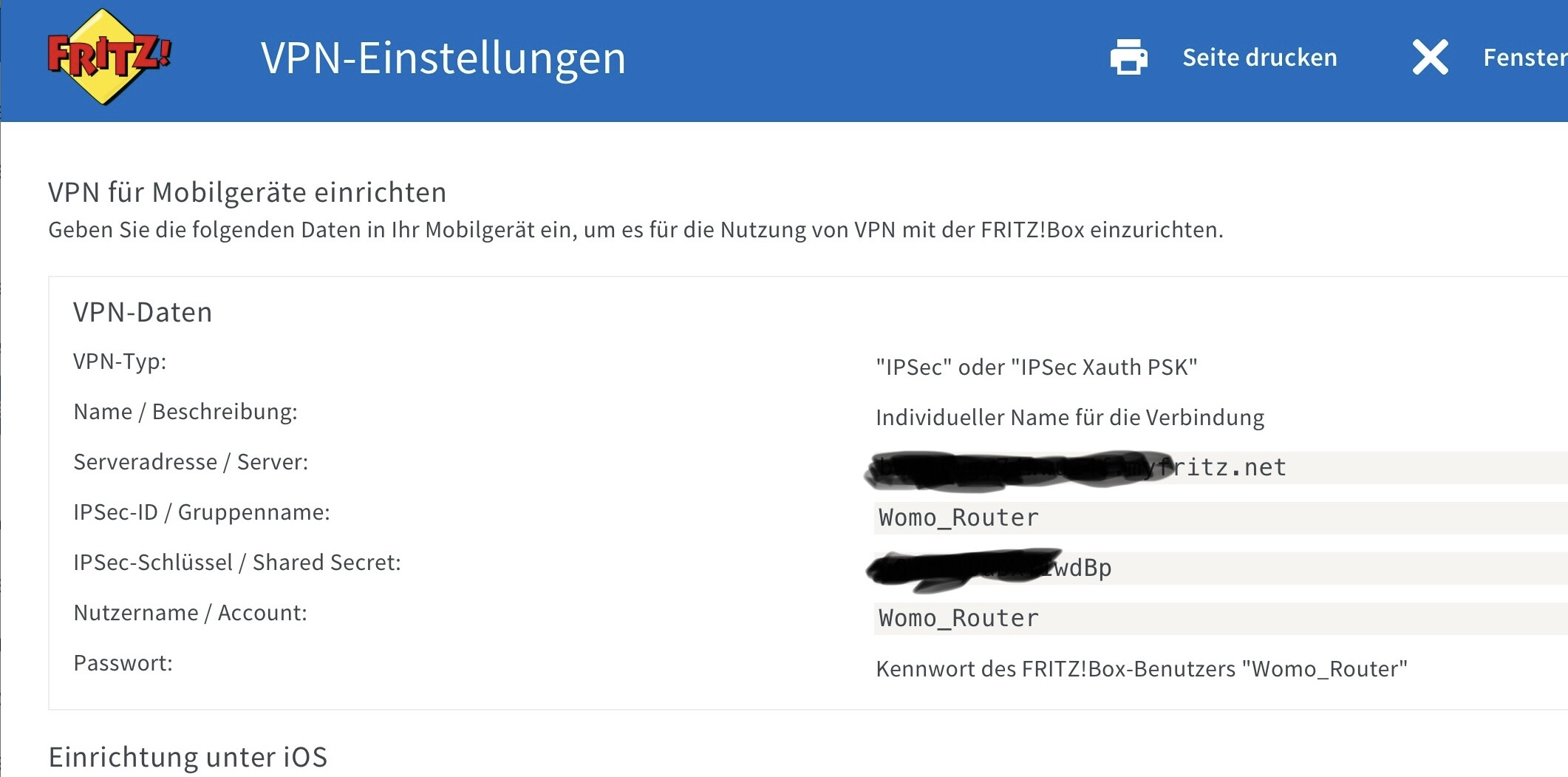

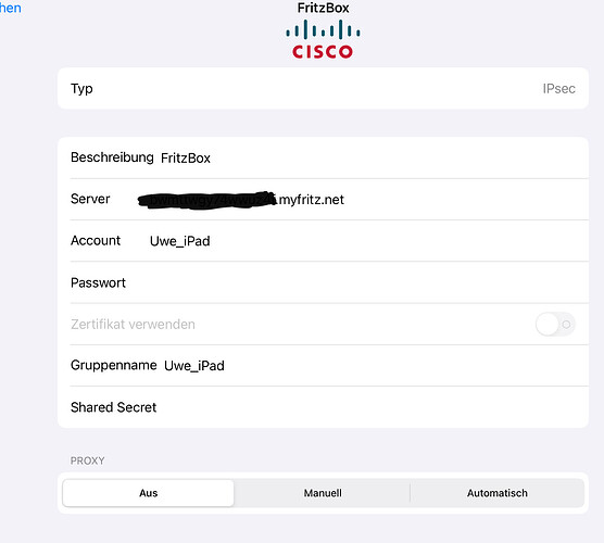

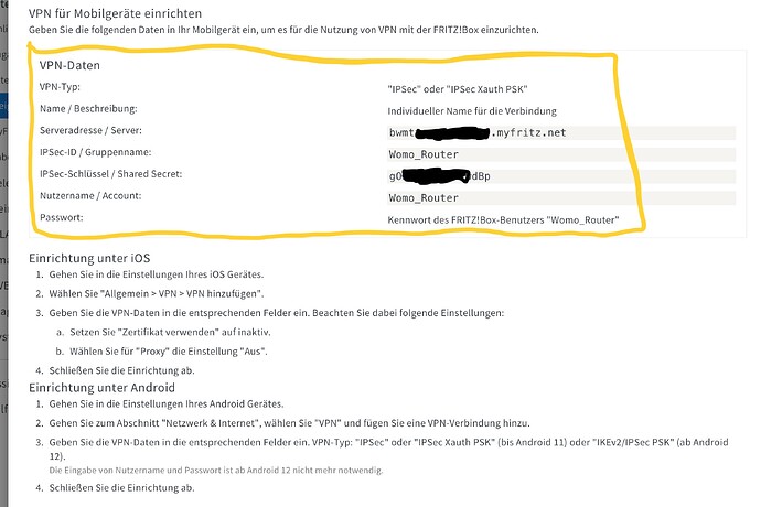

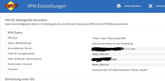

Since years I use VPN to my Fritz!Box using iPhones & iPads, there I a pretty easy guideline what to do for the setup.
There a basically 6 fields to configure - easy. I have attached both the ‚simple‘ config screens both for Fritz!Bix and iPad

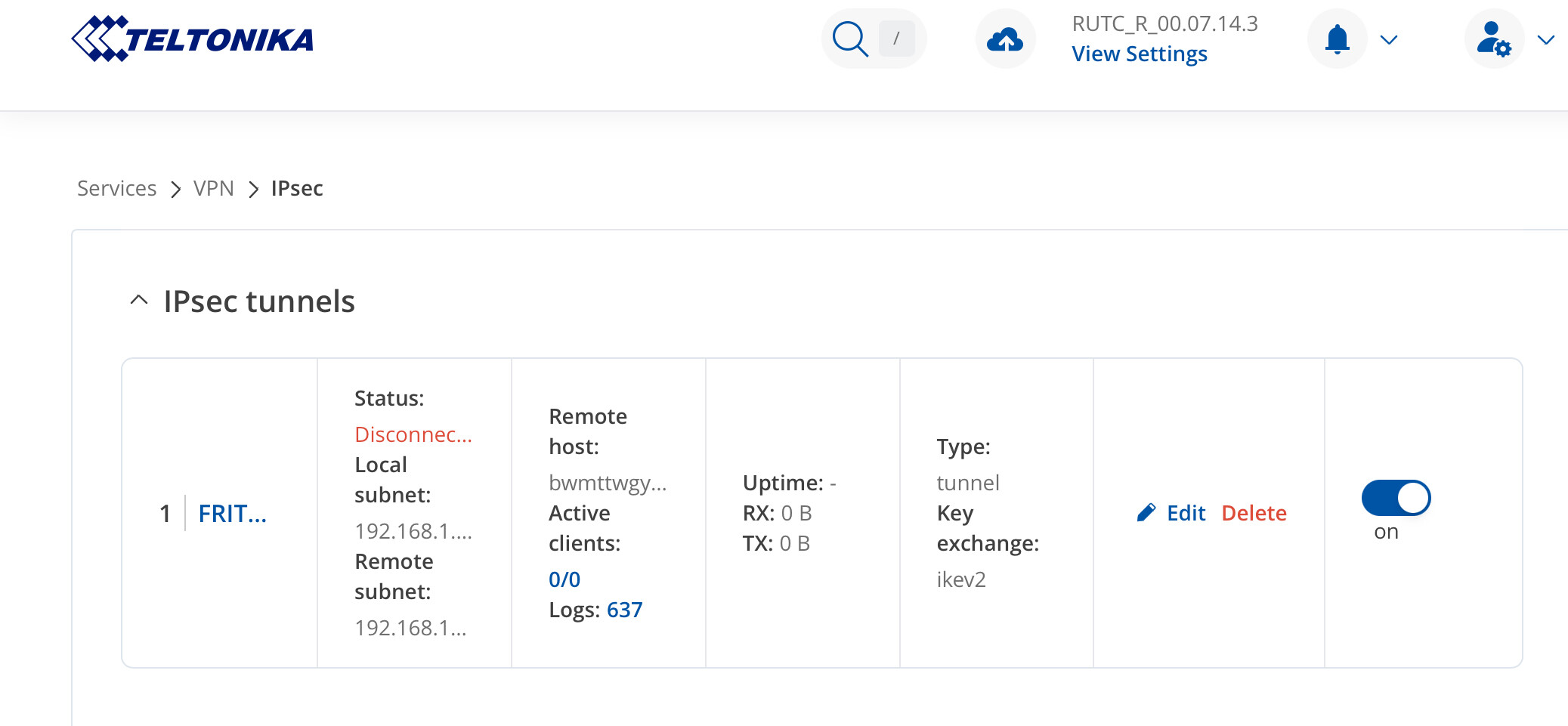

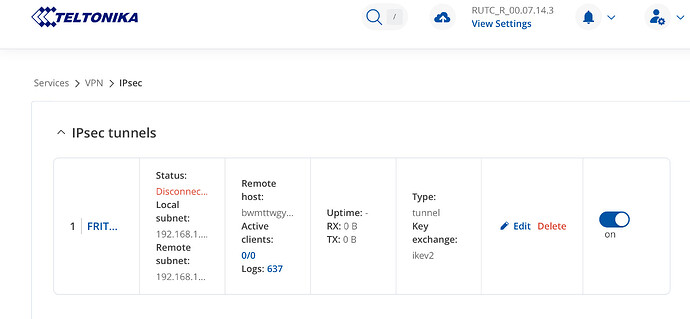

Here the logs ( last minutes from today ) and screenshots

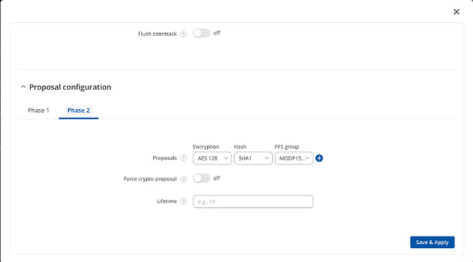

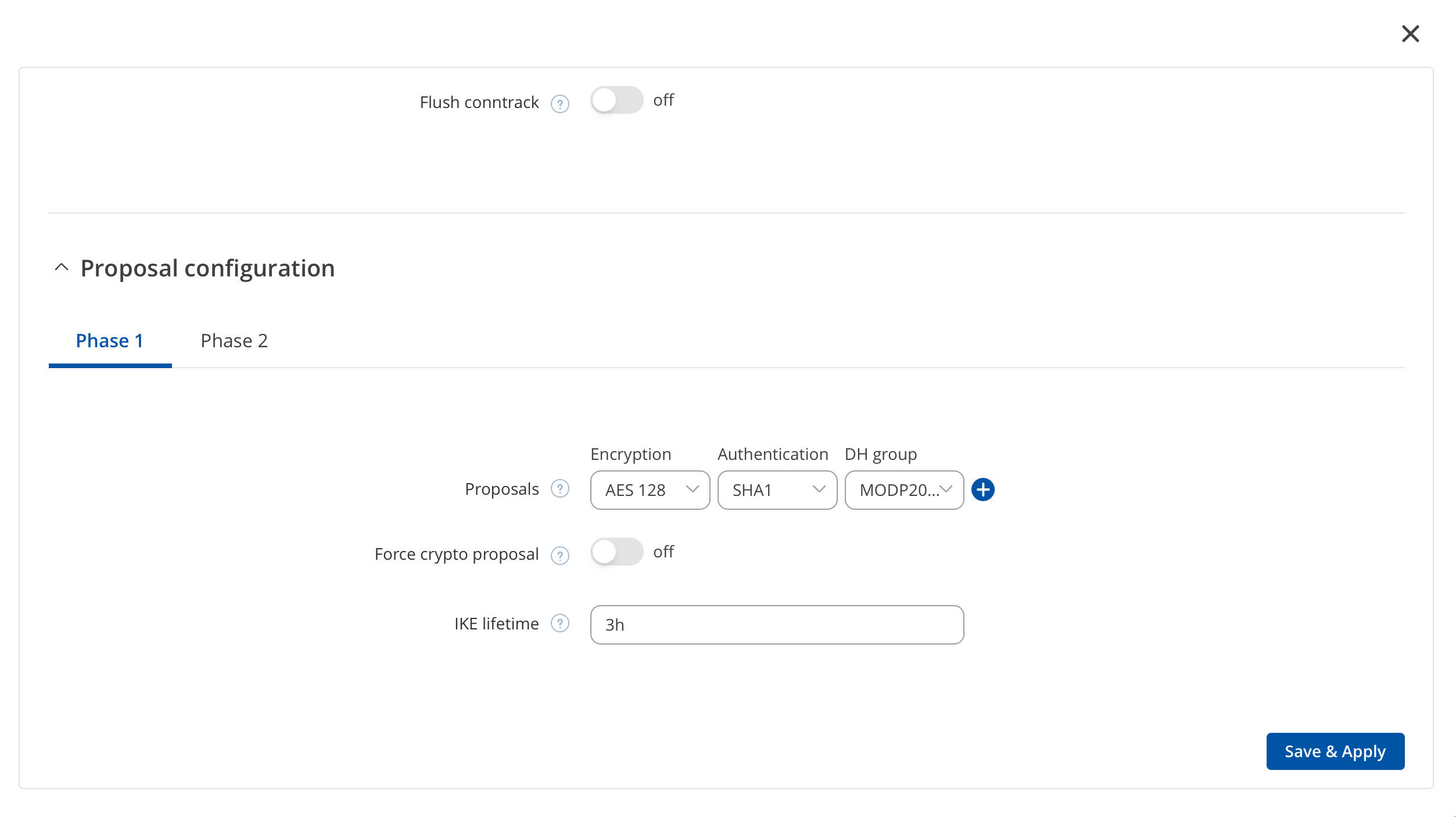

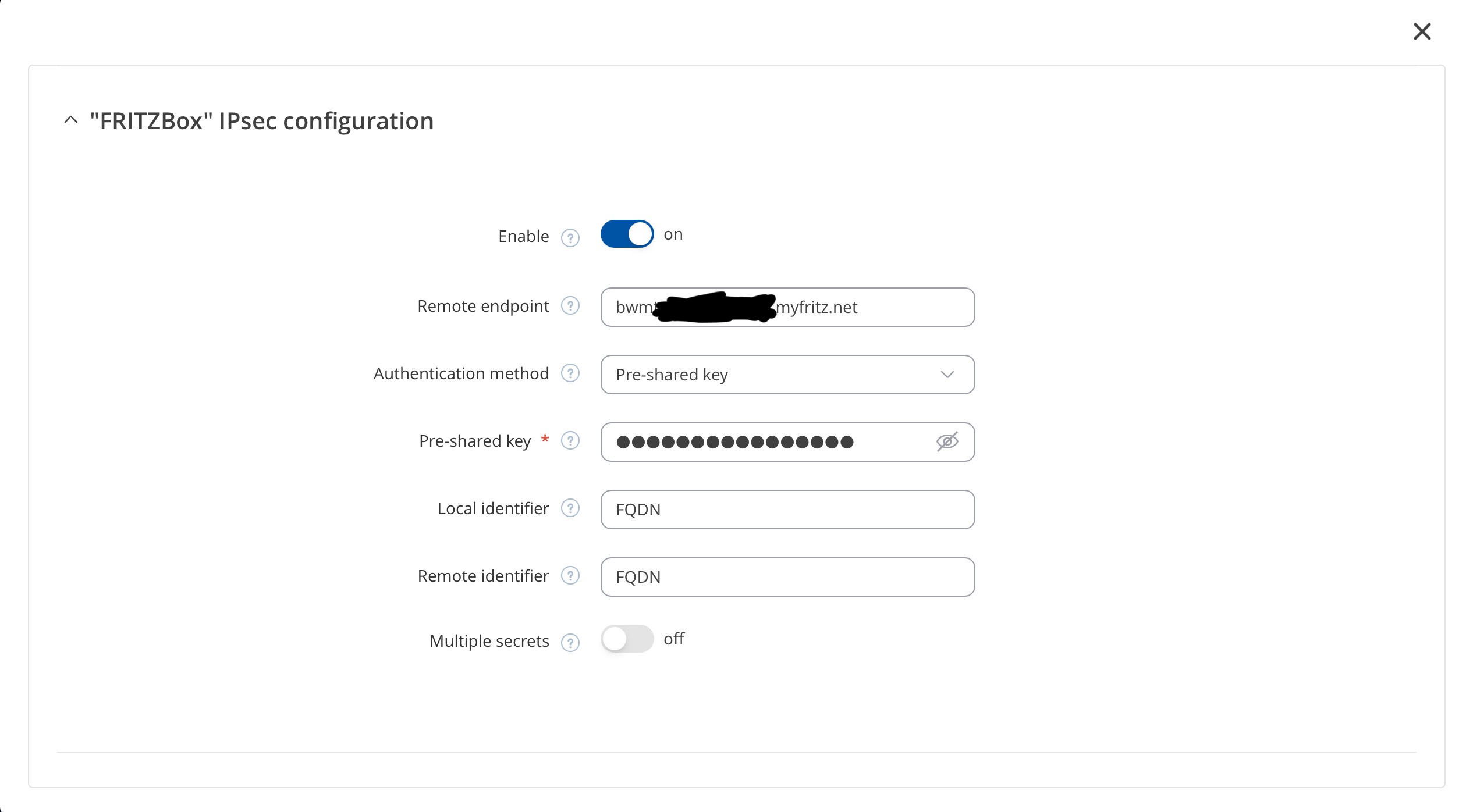

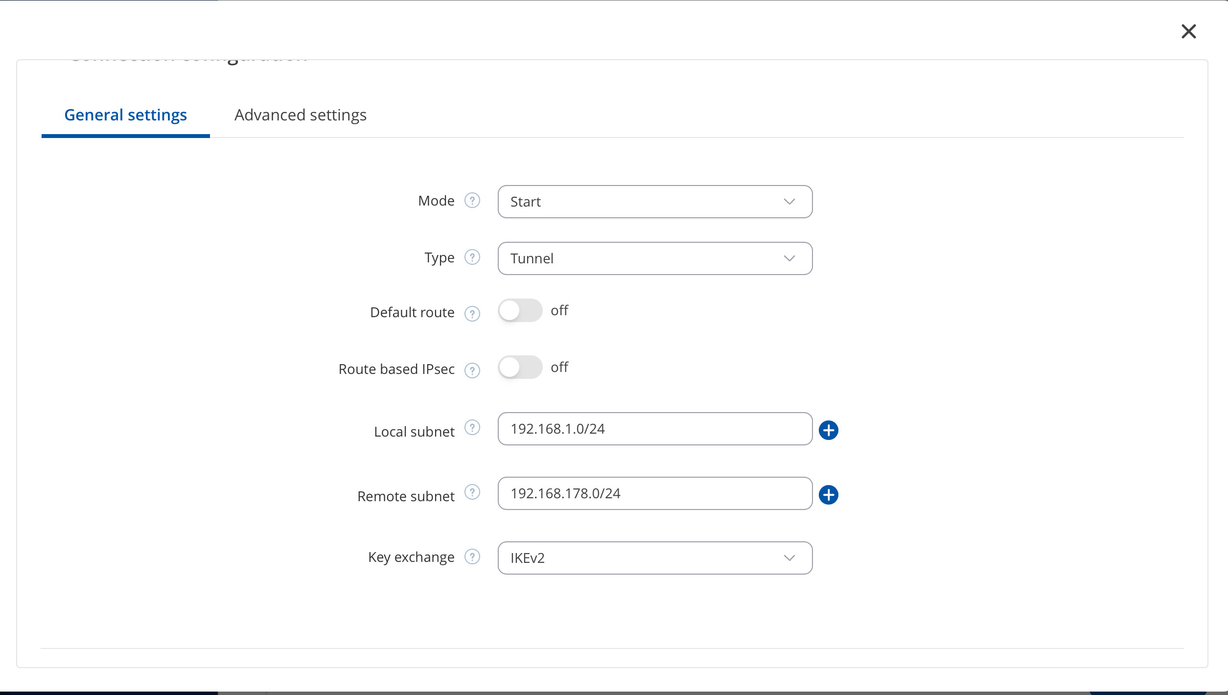

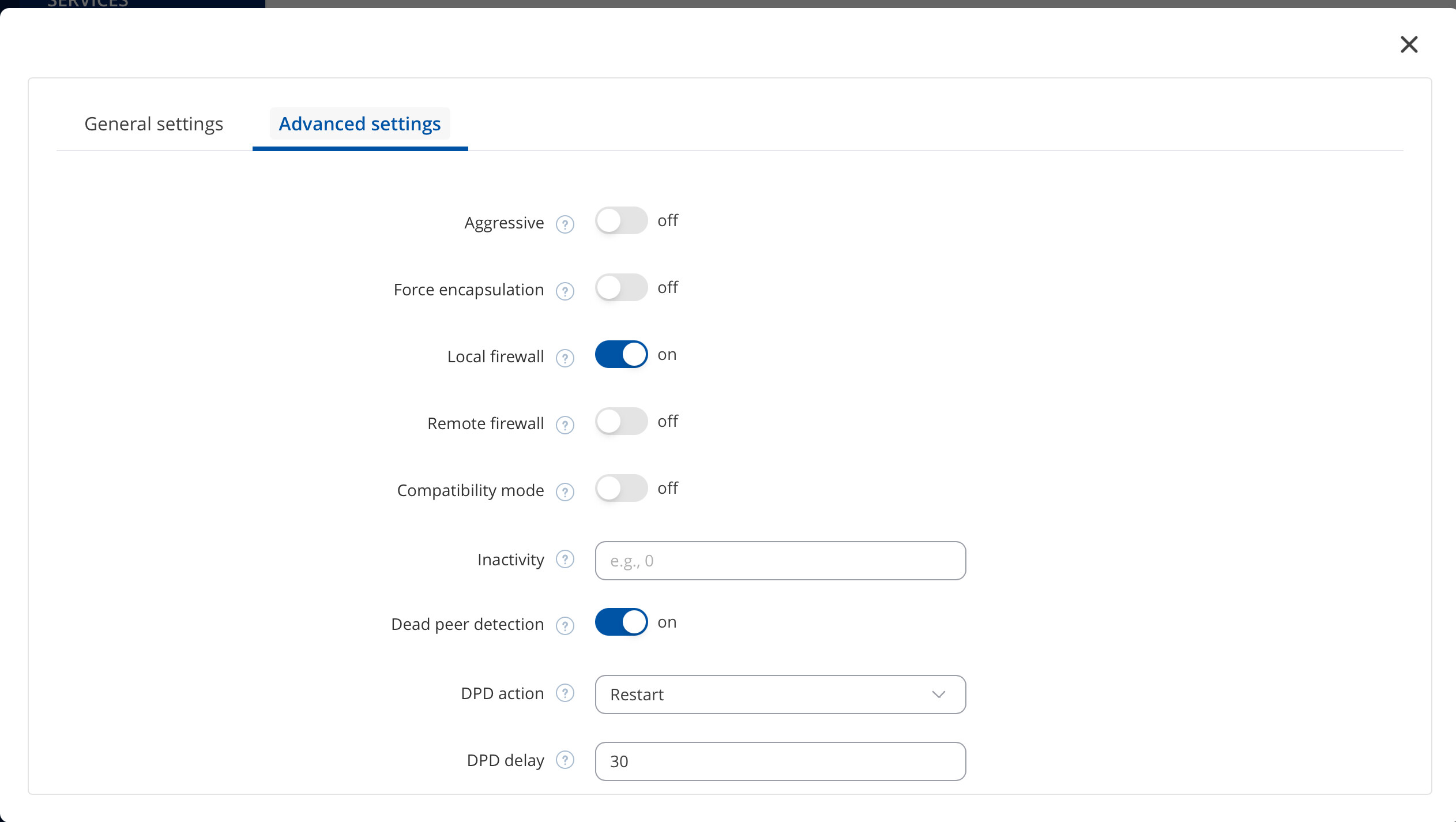

Below the IPsec settings from the Rutc50
Thank you for the additional information.

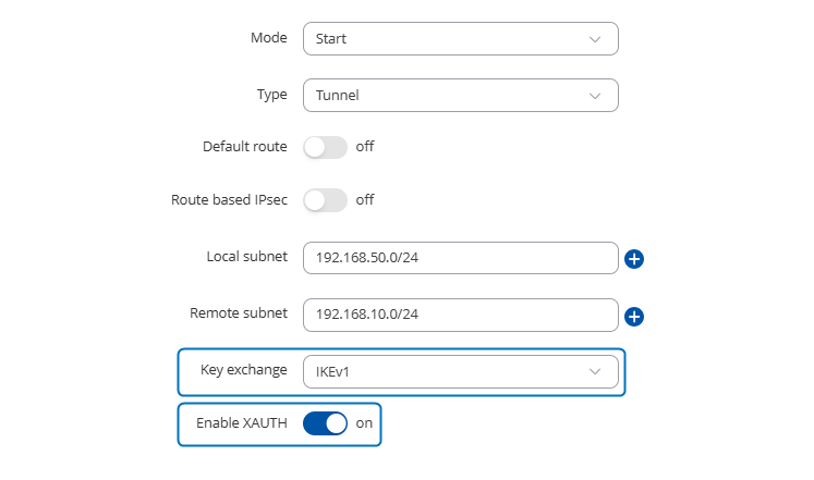

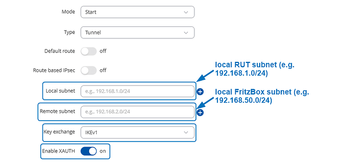

From what I’ve gathered and verified through some google research, the FritzBox IPsec VPN implementation follows the IPsec standard with ESP, IKEv1, and pre-shared keys. As I understand, FB does not support IKEv2, which could explain why the tunnel doesn’t establish.
In this case, for testing, I would recommend:
  • Selecting IKEv1;
  • Additionally, it’s worth testing the connection both with XAUTH enabled and disabled
  • Changing proposal algorithms to AES 256, SHA512, MODP4096 on both phases.
  • From authentication of ‘FQDN’ (myself) with pre-shared key log, the identifier might not match what the peer expects, hence try selecting different strings, e.g., peers’ LAN IPs
Lastly, make sure that the proposals (encryption, integrity, DH group) match on both ends for both Phase 1 (IKE) and Phase 2 (ESP). For instance, if the FB is configured with AES 256, SHA512, and MODP4096, the RUT device must use the same parameters. Also, the lifetime parameters (e.g., 24h) should be aligned on both sides.

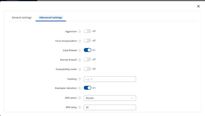

Hi, tried your recommendations and a few setting options … all failed.
Unfortunately on the Fritz!box side I can only configure these settings _
In a vpn help document from AVM ( Fritz!Box company ) it is mentioned to use a ‚Cisco Compatible Client‘ - this would explain why the iPhone shows ‚Cisco‘ in the settings.
I tried to figure out what defines a Cisco compatible … openVpN was one answer.
But even that I could not get to work.

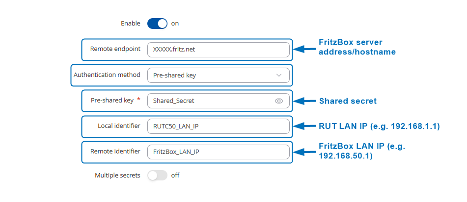

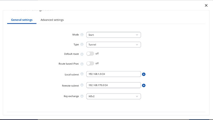

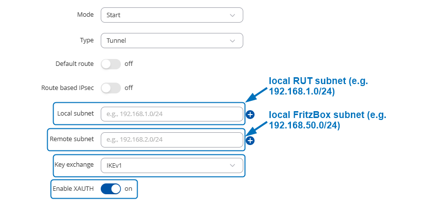

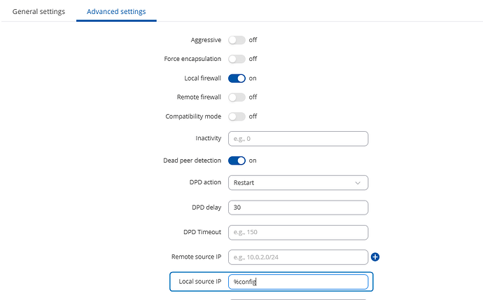

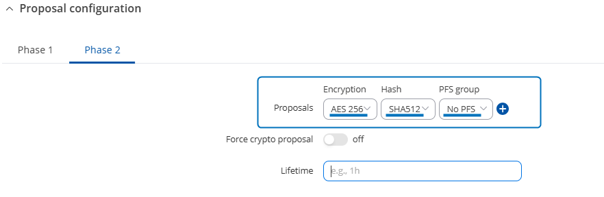

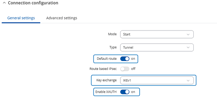

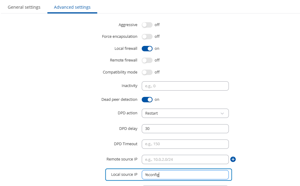

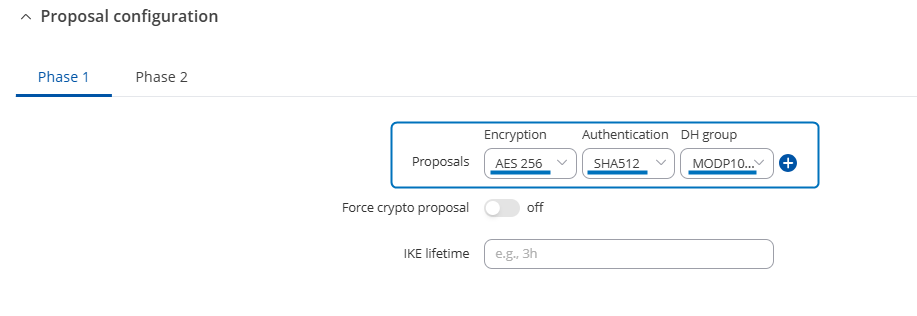

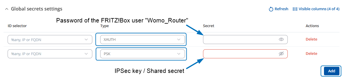

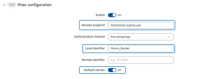

I took a more thorough look at this situation. In your case, the setup might be a little different. Could you give it a try following the configuration example provided in the screenshots below and let me know if that works:
1. IPsec configuration section:
2. Global secrets settings:
3. Connection configuration section:
3.1 General settings:
3.2 Advanced settings:
4. Proposal configuration:
I hope this setup will work for you. Let me know how it goes.
