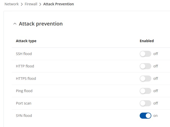

I can’t connect anymore to the firewall after upgrading to RUTX_R_00.07.14.2 from remote side in IPSEC VPN Tunnel. Have you found something ? I can ping it but cannot access webpage. On local side everything is ok
I just found this: If i disable “Port Scan” in Network - Firewall - Attack Prevention im able to connect from remote side to the firewall web page on IPSEC Tunnel. Can you test this
Seem to be this solution : Https from wan side on 7.12 now taking minutes - NETWORKING SOLUTIONS - Teltonika Community
nothing helps
