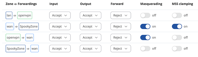

Now the next step I want to do is have two separate WLANs (SSIDs), where one of them goes through MullvadVPN and the other one (guest) does not. I have created the WLANs which are working fine, with different SSIDs and passwords.
However, I am not able to have the guest network go directly to the internet. Whenever I look at wimi.com or similar it is still “behind” the mullvadVPN. My impression was that I should set up Firewall Zones which I have done like this:
Where the “SpookyZone” is the unprotected LAN which uses the Guest WLAN. What am I doing wrong here? How can I direct all the WLAN traffic to go directly to the WAN without VPN?
