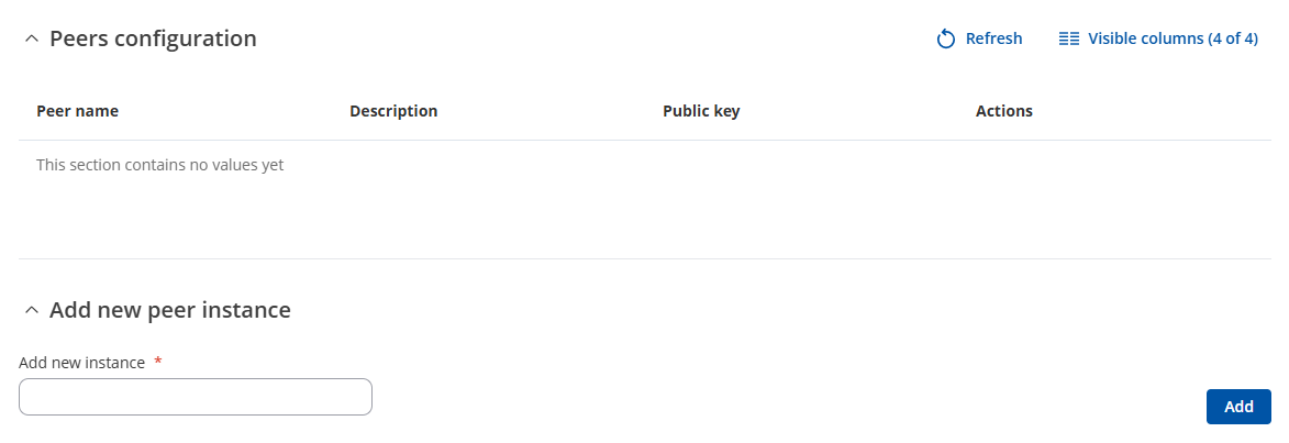

WireGuard VPN doesn’t directly lease out IP addresses to its clients; rather, it is based on pre-configured peers, which means that you would have to set up WireGuard on your clients as well so you can add them to the server configuration, or more specifically, to the peer’s configuration list:
