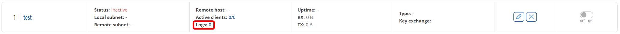

Please navigate to Services → VPN → IPsec, and on the created instance, press the number next to the Logs: line:
Hi Daumantas,
As you can see in my initial screenshot, there is no instance visible in the gui. There is a working tunnel however.
Leon
@Daumantas can you indicate what you need? The topic will close in 20 hours.
Could you try reconfiguring the IPsec instance manually using the WebUI? Some UCI options could have changed which can definitely cause issues. We suggest re-creating UCI configuration every major firmware release (07.04.x, 07.05.x…) to avoid issues like this.
