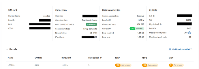

Lastly, it would be helpful and appreciated if you could provide a screenshot of the Status → Network → Mobile page, with any sensitive information such as public IP addresses, IMSI, ICCID, or cell IDs hidden.

Thank you for the update and providing a screenshot.

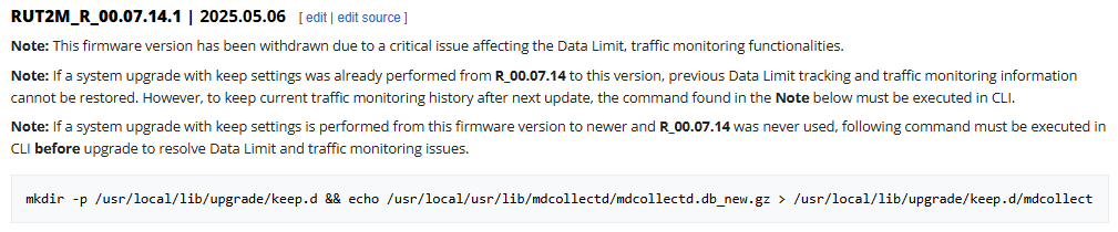

The first thing I’d recommend is considering an upgrade to the latest firmware version, 7.15, or at least to the previous stable 7.14.3 release.
Also, could you please clarify from which firmware version you initially upgraded to 7.14.2? If it was from 7.14 or 7.14.1, I trust you followed the mandatory update instruction outlined in the official firmware wiki page or here on the forum.
Firmware update from 7.14 / 7.14.1 instructions
From the screenshot you shared, it seems the LTE signal is excellent, and the other signal parameters are also quite good. I’m assuming you might be using a better external antenna now, could you confirm what type/model it is?

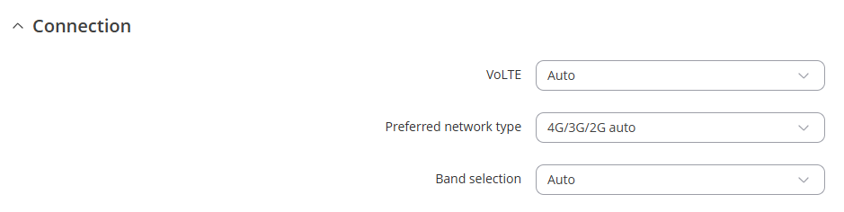

Additionally, is band lock currently enabled? If so, it might be worth disabling it temporarily to see if the modem can connect to other available bands with higher capacity or better performance.

No the band is in auto mode :

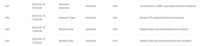

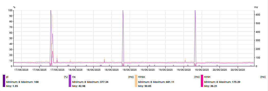

To complete my answer, we have a PAP authentication with 4G, and we think each 24h the router reboot or re-authenticate with the account because in the graph under you can see the link down. Why ?
Is it a problem with 4G and PAP auth ?
For each router it’s not the same hour, but it’s 24h too, and the customer the the break down during 20min approximatly.

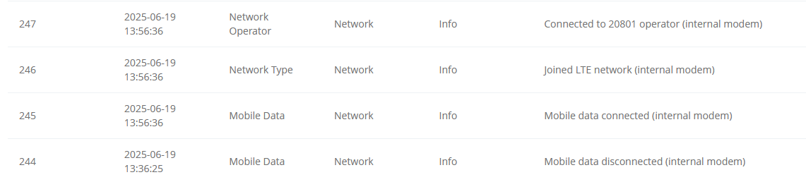

In log we can see this :
