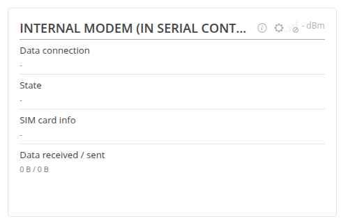

Good morning and thank you.
I’m starting to run some tests, and if you have any experience and/or suggestions, I won’t waste too much time and I’d be grateful.
So,
if I use the TRB142 normally via a ThingsMobile SIM with a fixed IP, I can reach the modem remotely.
I haven’t looked in the menus or the manual yet, nor have I tried, to see if there’s a serial server that can forward packets arriving (via the logger’s software) on port 6785 to the serial port and establish a connection with the logger. At least, that’s what I’ve done with other devices.
This, however, would be a plan B, since if the PPP procedure fails, the logger won’t know it’s on the internet and won’t be able to use the relevant protocols (email and FTP), but will only be able to answer IP calls remotely via dedicated software.
However, if I set it to full control, the TRB142 seems to stop doing anything. I assume this is because it’s waiting for AT commands on the serial port from the logger.
The logger, thanks to its programming, starts sending strings for the PPP connection. I can see the traffic on the serial port, save it, and attach it, but something isn’t working and the PPP procedure isn’t successful.
I send the traffic as an attachment when the PPP fails, and also with another serial modem when it does. Perhaps with your experience, you can figure out what’s wrong with the TRB142.
traffic with no PPP

*** Note: Recording stopped because the logger reported that it had acquired the IP address and the PPP was successful.
I noticed a clear welcome message that never arrives in the TRB142.
This would be my preferred solution, so that at set intervals the logger could send the data to an FTP server, where the client could retrieve it more easily than with plan B.
I could also send emails to notify users of situations and alarms more quickly.
