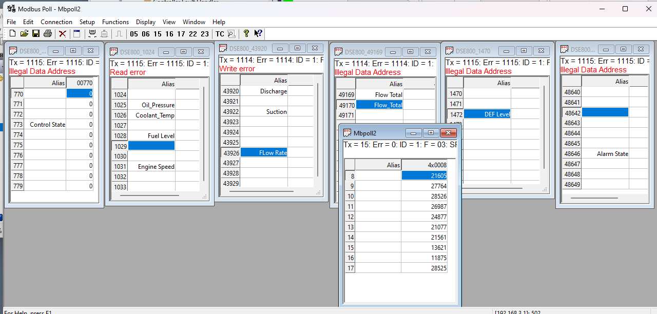

I have established a Modbus poll workspace which works perfectly when
polling a DeepSea E800 controller.
When - both through its ethernet via ModbusTCP and via RS485 through a USB adapter.
When I point to the RUT955 “gateway” address everything comes up
illegal data address
_except a profile which I accidentally created and then optimized…
which reads from address 8 through 17.

I was getting Illegal data address errors even before I had connected the RS232 cable
and the address 8 to 17 data was appearing… I thought something is up…
