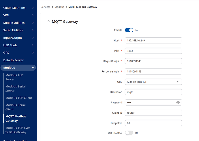

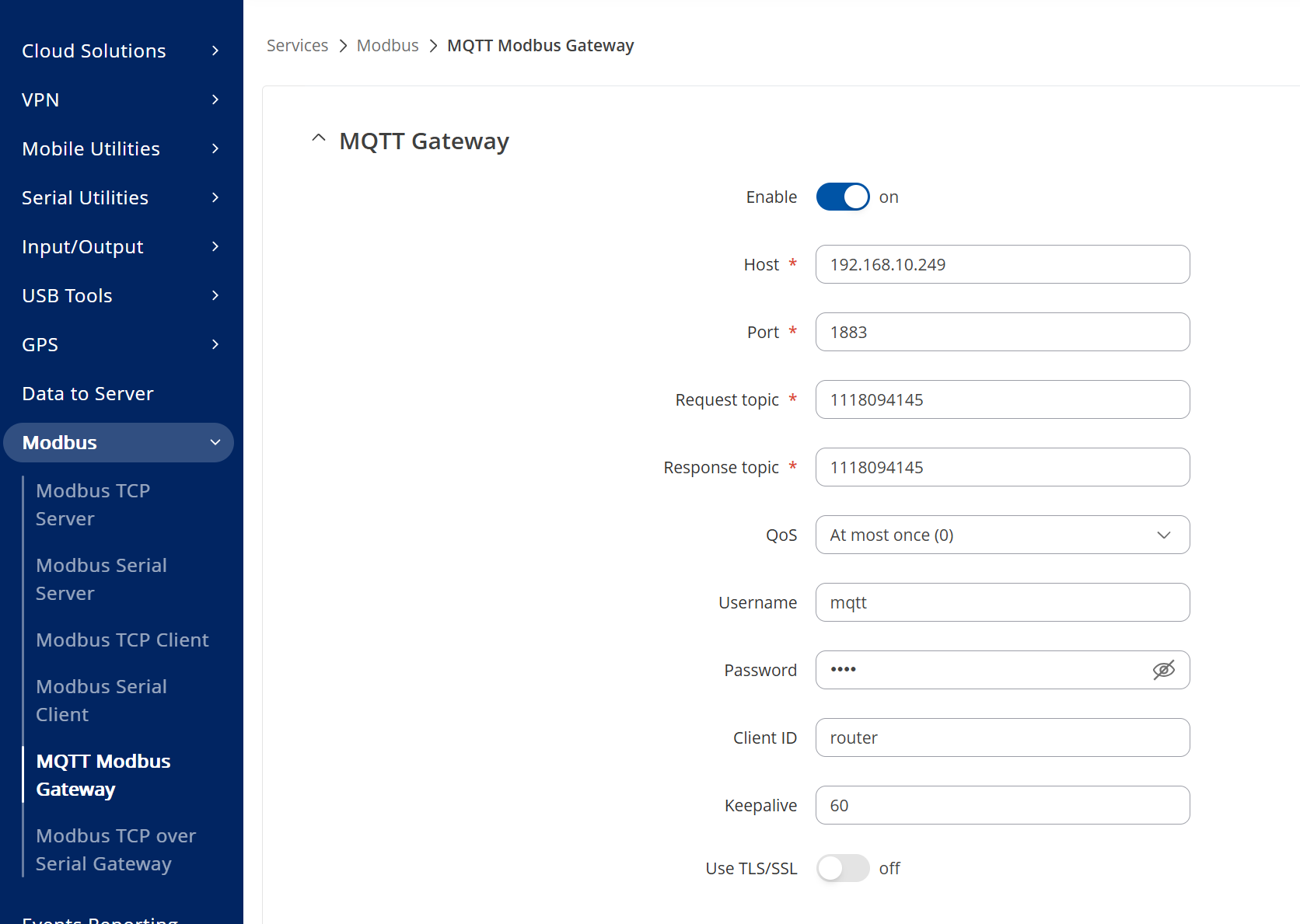

I’m trying to send router info to a HA instance running Mosquito Add-In.
I’m running RUT9_R_00.07.06.16 FW. on a RUT955
I only see one MQTT page in the settings menu and it is configured like this:
192.168.10.249 is the static IP of the HA instance.

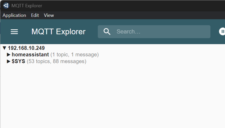

Using MQTT explorer I can see the HA Broker
but not the Router.
Can anyone help troubleshoot the issue please?
