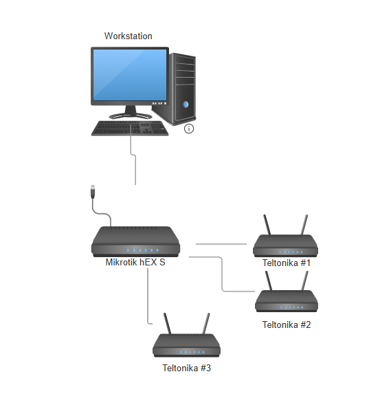

Please excuse the crudely drawn diagram, but this is what I’m trying to achieve
On the MikroTik, I have set it up, so each router connected to the Mikrotik, uses a different ethernet port, i’ve then set up destination ports 8001 / 8002 / 8003, so i can use my workstation browser, going to 192.168.88.1:8001 etc. The idea is being able to connect to each Teltonika using the different ports so i can update the firmware and configuration files on each individual router, whilst having three connected.
We want to program multiple at the same time, and they are all on the same default IP of 192.168.1.1 and we want to update the firmware and import a configuration on them at the same time on the VLANS. But by going into each one individually it slows our process down so we would want to be able to access all 3 at the same time.

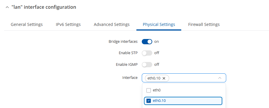

Apologies for the delay. If keeping the default LAN IP of 192.168.1.1 on each RUT is necessary, one possible approach, though I’m not familiar with MikroTik’s exact configuration flow, would be to utilize tagged VLANs (e.g., VLAN IDs 10, 20, 30) on the required MikroTik Ethernet ports. You could then create separate interfaces for each VLAN on the MikroTik, assigning IPs, e.g., 192.168.1.254 for each respective VLAN.
On the Teltonika side, you’d configure a tagged VLAN interface for each router and assign it to the appropriate physical LAN port in the Physical Settings of its LAN interface.
This way, when your computer is in, for example, VLAN 10, it would only see the first RUT at 192.168.1.1 within that VLAN. The same principle would apply to the other VLANs and devices. It should allow you to manage and configure each unit simultaneously without IP conflicts, provided your workstation can switch or tag traffic appropriately.
