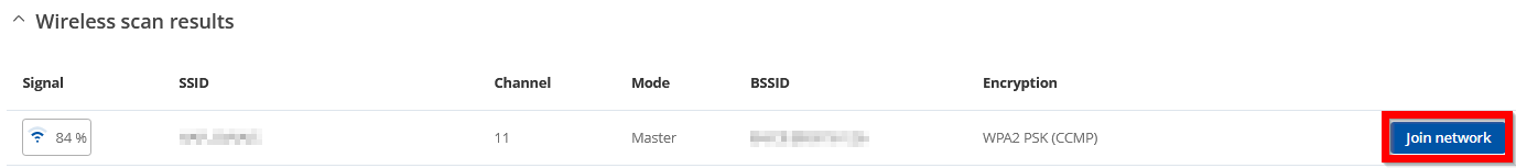

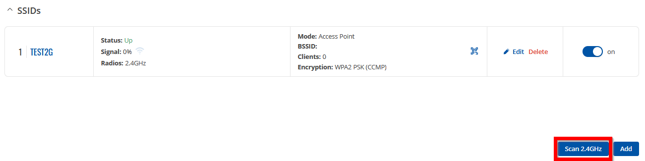

If you only want to connect the RUT240 as a client to an access point, avoid using the configuration you mentioned. Instead, follow these steps for a straightforward connection:
  1. Navigate to Network → Wireless → SSIDs.
  2. Click “Scan 2.4GHz”.
3.And in the new pop-up window select the desired network and click “Join network”.
  1. Enter the necessary credentials.

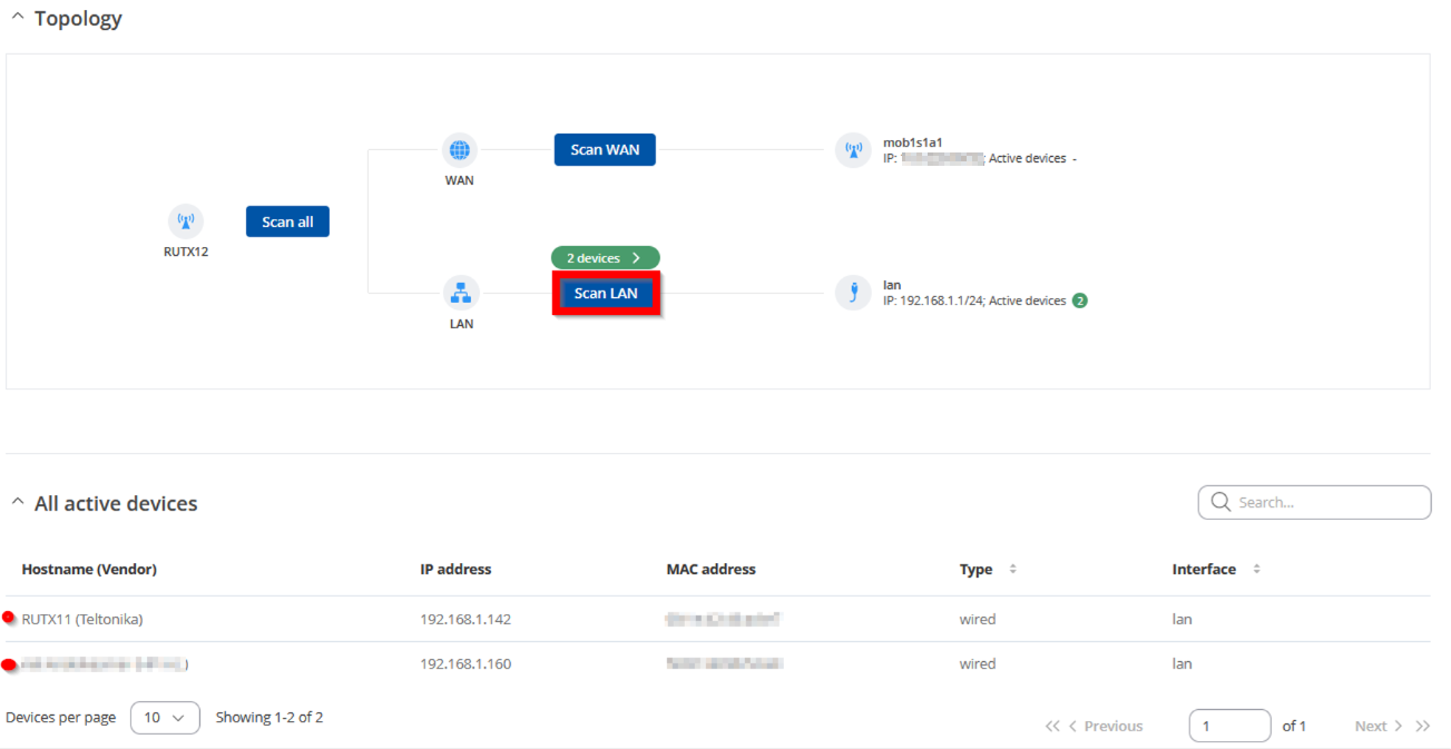

I configured the wireless mesh and it works. I can access the clients on the second Teltonika. I only have one problem: I can find the Teltonika 1, which is connected to the Internet, in the network, but I can no longer find the second Teltonika, which is not connected to the Internet, in the network. Is there a solution for this?
Other mesh nodes should be reachable. Please go to Status → Network → Topology and press “Scan LAN”. You’ll be able to see connected devices. There you should find your other mesh node IP address.
