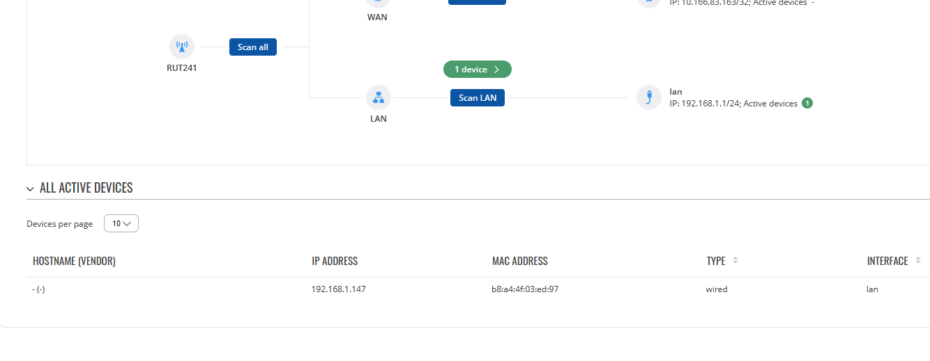

We have RUT241 connected to our OPENVPN Server and there is host connected at LAN side of the RUT
For some reason we cannot reach the host from our OpenVPN
RUT gets 10.2.0.x IP
Host IP 192.168.1.147

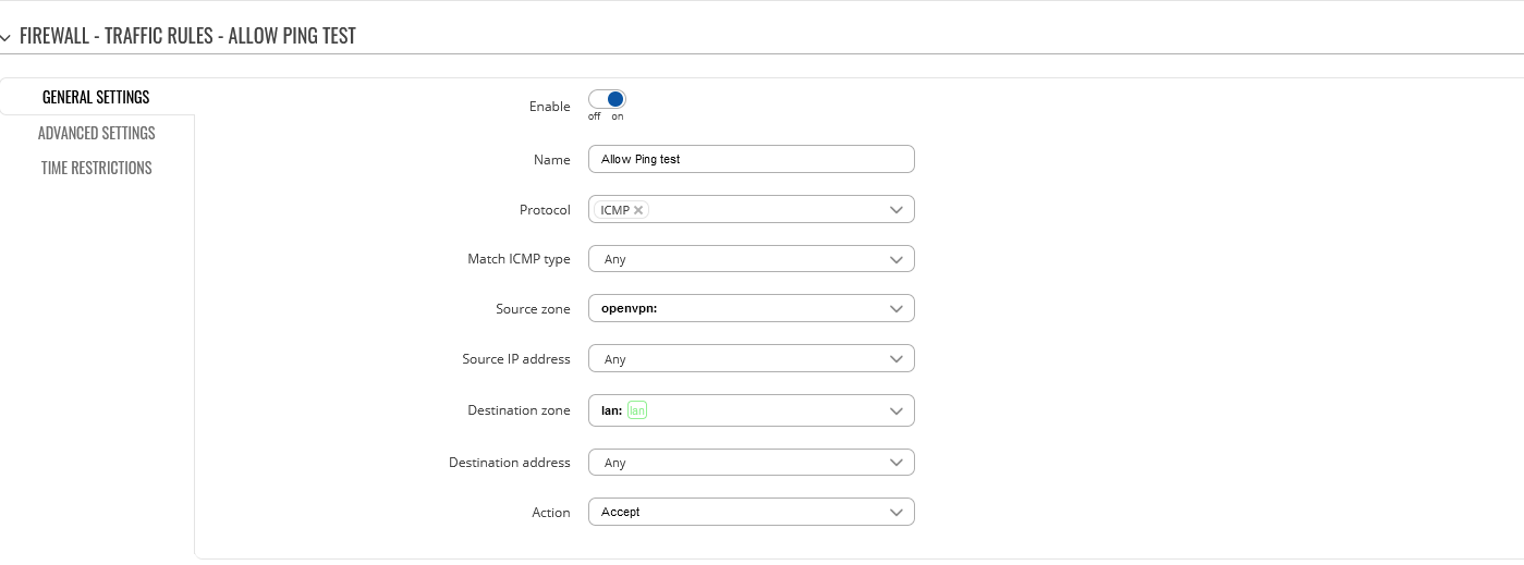

FW rule set from source OpenVPN to LAN as below

If you only need to access one client with ICMP, then routes are not necessary. Make sure you specify the LAN host IP address in the destination address field of the firewall rule and try pining the RUT241 virtual IP address. The ICMP packets wilk get forwarded to the LAN client.

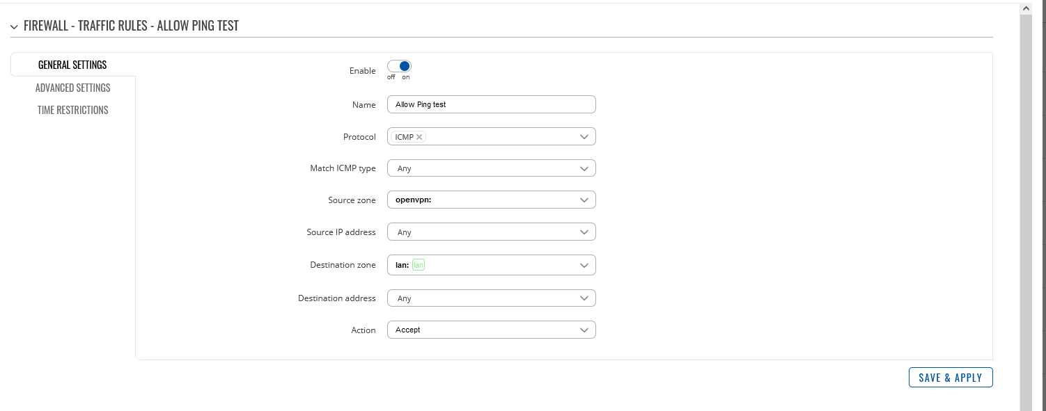

If yes, you mean to allow destination ICMP to host IP of 192.168.1.147 as per screenshot?
I have tried adding the destination address but it is still the same and it does not ping

Alternatively, remove any created/modified firewall rules and setup Port forward from OpenVPN zone to LAN zone and destination host 192.168.1.147. Make sure to allow all protocols.
This way you will be able to reach the LAN device using the virtual IP 10.2.0.x.
