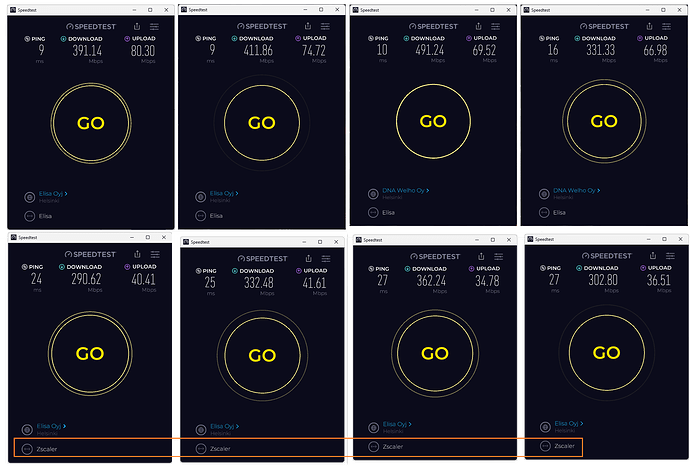

I’ve been running an RUTX50 as a domestic router for several years now. I have a 600/50 5G SA connection from Elisa in Finland and performance is okay I guess (the connection has started dropping for no apparent reason recently though…)

I don’t know if its my ISP but the performance of the RUTX50 has been better in the past. Again not my reason for upgrading.

This looks like a congested tower. Try that SIM in 5G capable phone, im pretty sure you will get same results.
@heartless good point, I will do so tomorrow and report.

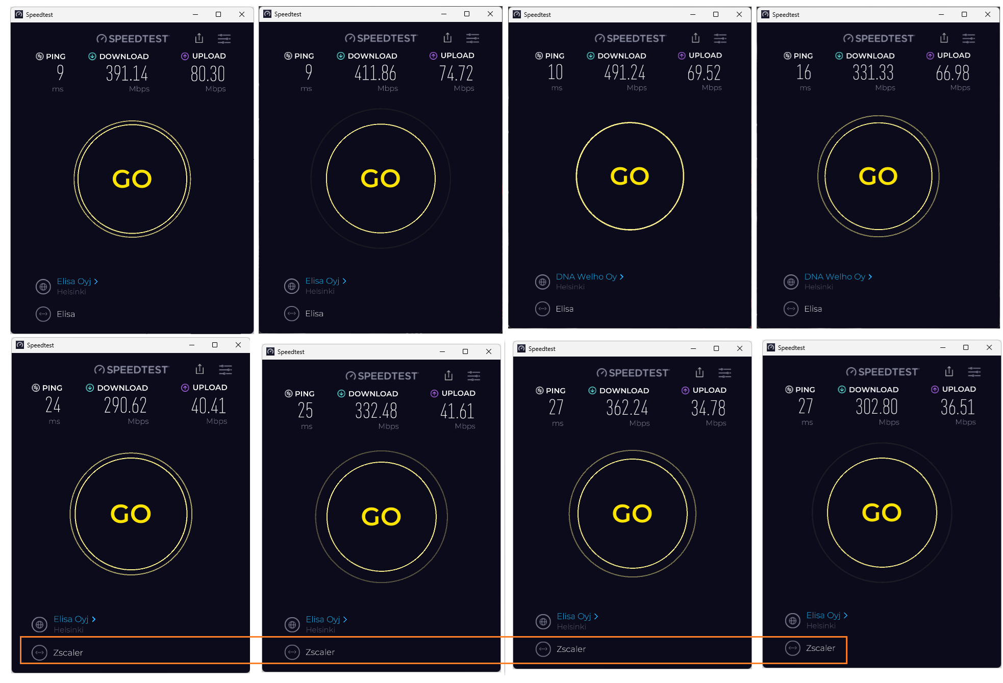

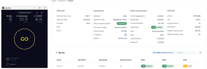

@heartless @Marcelo.Barros my stupidity in this case. I was using the PC provided by my employer and they installer a “Zscaler” cyber security system which I didn’t notice was affecting the Speedtest app tests. The upper examples are from a personal PC.
