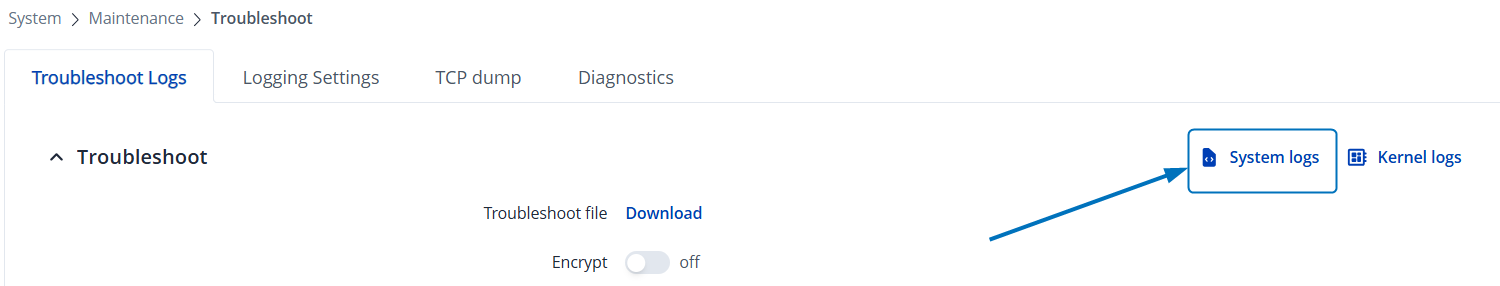

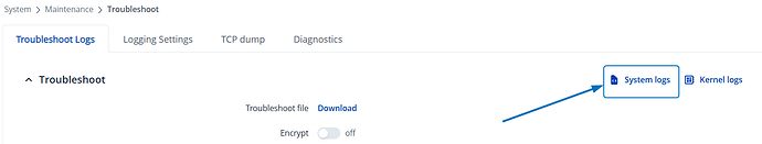

  3. Could you provide system logs captured immediately after the issue occurs? You can see them navigated to System → Maintenance → Troubleshoot page, System Logs field:

Hello @duqui,
Thank you for your update. In this case, to assist and troubleshoot this case effectively, we’ll need to continue this process privately, because sensitive/publicly unshareable information, such as the troubleshoot file, public IP addresses, serial numbers, etc., needs to be collected.
You should find a support request form in the inbox of the email address you used for your forum registration. Kindly fill out the form, and please reference Ticket ID: 15414 when submitting it. Once the form is completed, we’ll contact you directly via email to investigate the issue in detail and help work towards a solution.
