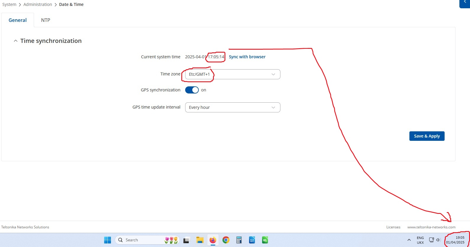

Instead, the timezone automatically changed to etc/GMT+1, but the system time was 2hrs behind.
So system time slipped back an hour whilst the time jumped forward an hour!

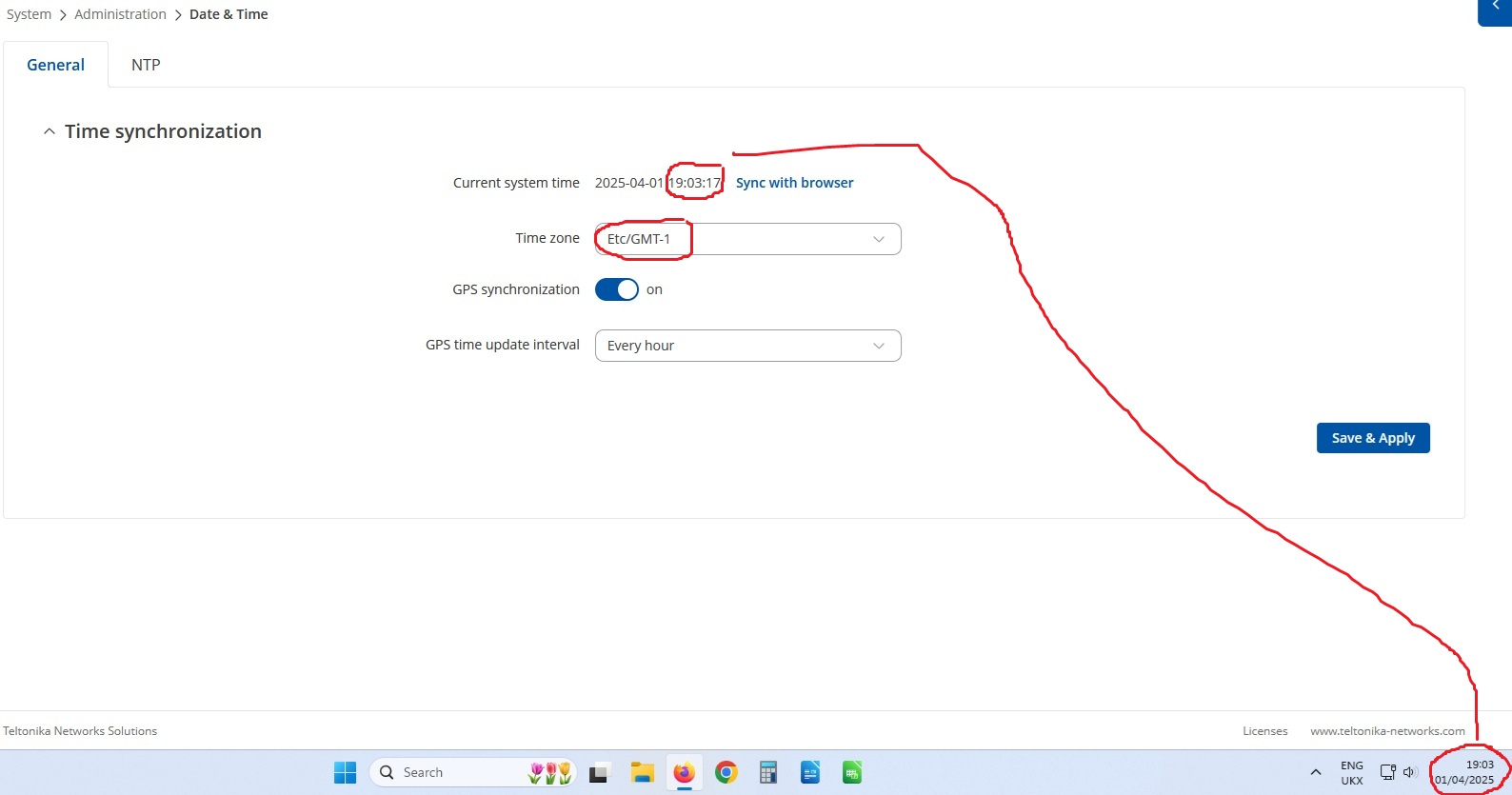

So i re-selected Europe/London, applied and saved. I then noticed that the timezone changed to etc/GMT-1, this as i understand things would move the system time back an hour and 2hrs out of sync with the actual time, but the system time is in fact correct???

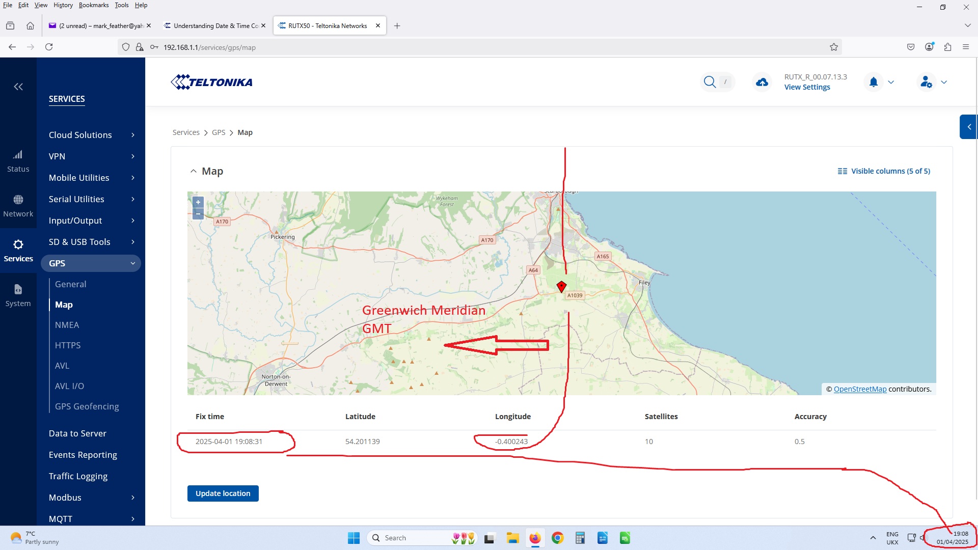

Auto update of the time is enabled and auto updated incorrectly, the system time was 2hrs behind actual time. I’ve had to manually correct it by selecting as i understand things incorrectly. British Summer Time (BST) is GMT+1 not GMT-1.
When i select GMT+1 which as i understand things is correct for all those within the UK the system time is 2hrs behind the correct time!!
OK think i’ve got this!!
GMT-1 at my longitudinal position, means the system time is 1hr behind the meridian as the globe moves round and GMT+1 at my longitudinal position, means the system time is 1hr before the meridian as the globe moves round.
So at my longitudinal position with a setting of GMT+1 i would be 2hrs adrift.
My Brain hurts, where’s the Brandy Bottle and those Paracetamol tablets!!?
The system time still auto updated incorrectly though!

So the time format is correct. Is it confusing? Absolutely
Thank you Paulius for the detailed explanation.
However when the clocks moved forward an hour the other weekend the system time auto updated and became 2hrs behind BST.
I’ve changed the time manually so that the system time is now correct so it’s not an ongoing issue until the autumn perhaps when the clocks drop back an hour.
