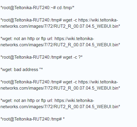

I am trying to use the wget command to upgrade my teltonika to a newer version.
The device has a 4G sim inserted but it is flapping a lot and hence it is offline in the RMS portal.
*This device is used as a wireless backup on a sdwan device. *
Hence I am sshing to the device through the sdwan box. I get the below error while trying to download firmware RUT2_R_00.07.04.5_WEBUI.bin.
wget: not an http or ftp url ? How do i fix this ? Thanks !*
Screenshot 2024-04-06 213519
Please try this link without -c flag added:
wget https://firmware.teltonika-networks.com/7.5.4/RUT2/RUT2_R_00.07.05.4_WEBUI.bin
If this still does not work, try this curl command instead.
curl https://firmware.teltonika-networks.com/7.5.4/RUT2/RUT2_R_00.07.05.4_WEBUI.bin --output firmware.bin
