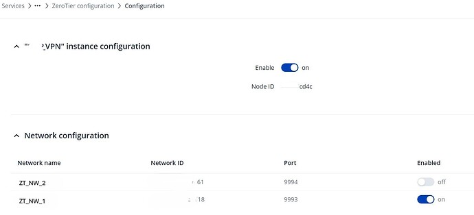

Hi again,
Some added screenshots to clarify

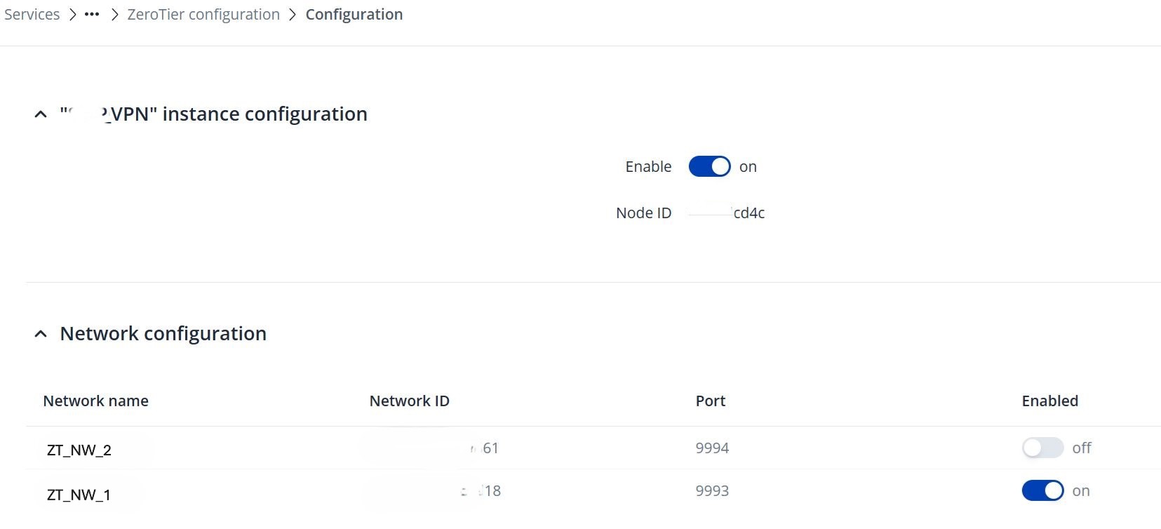

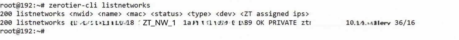

Unable to connect to two zerotier networks at the same time using RutOS GUI
I have a single zerotier configuration with two networks configured, lets call the ZT_Nw_1 and ZT_Nw_2.
When I enable the ZT_NW_2 and check with CLI and zerotier-cli listnetworks. Only the ZT_NW_1, which is the second NW in the NW-conf list in the GUI, is shown.
When I change the order in the GUI, it’s still only the last that appear with CLI zerotier-cli listnetworks.

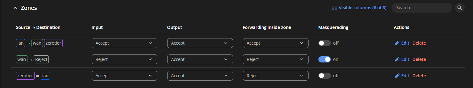

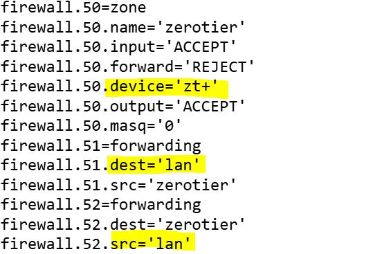

On the How to set up the firewall.
Here is the zerotier zone as shown with CLI uci show firewall
The zerotier zone includes the wildcarded device=zt+ and accept traffic to/from LAN by default, however we do not have any network called LAN.

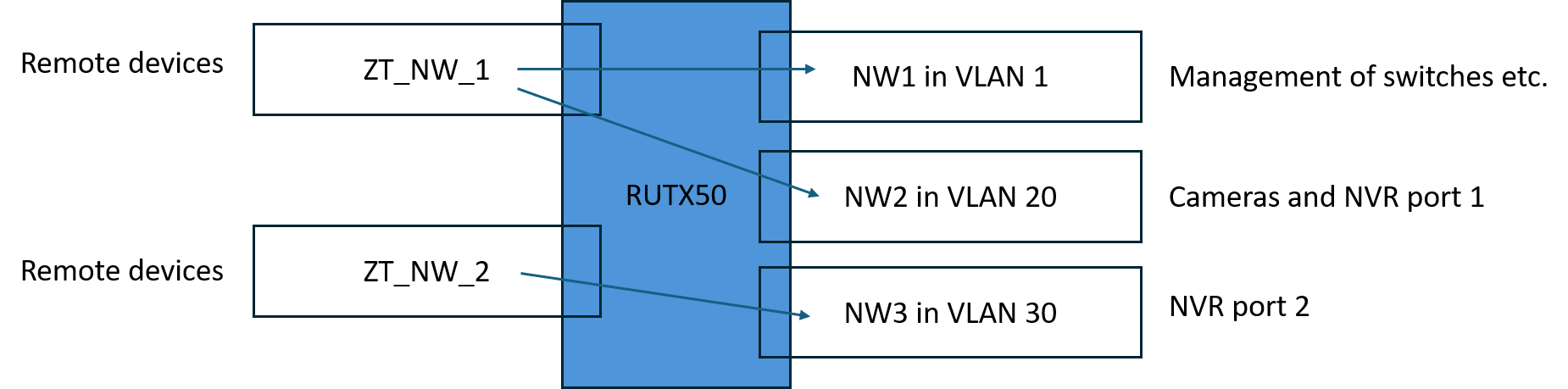

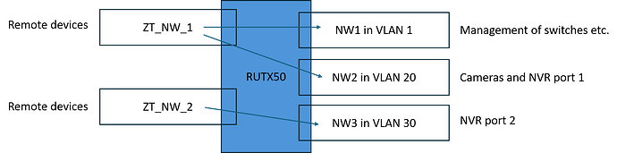

Q3: Could you provide a simple network diagram showing both ends of the ZeroTier connection, including which interfaces are bridged and where the end devices are connected?
Our ZeroTier networks consist of members where the RUTX50 is the member to receive traffic from the other members that contain clients and browsers.
The ZeroTier networks contain managed routes similar to the one in the wiki-paper mentioned above. These routes are exposed through the ZeroTier clients which enable us to communicate using IP-addresses of the nodes connected to our VLANs.
The managed routes are the IP-addresses of the ZeroTier network where the ZeroTier members are connected to e.g. 10.xx.yy.0/16 (These are not used, except the router address) and in our case we have added the addresses of the networks in our VLANs like 192.168.zzz.0/24 via10.xx.xx.236 (the IP-address of the router in the ZeroTier network)
Here is a simple diagram
A solution could be to let the each of the two ZT networks end up in its own zerotier zone and handle the routing as zone policies, but I could not do this in the RutOS GUI.
As I have mentioned before it is important for us to have a solution built on clear easy to understand principles and configuration methods that are future proof.
Kind regards
Anders

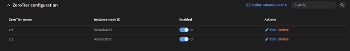

  1. The firmware version used during testing was RUTX_R_00.07.24.1.
  2. I was unable to reproduce the reported issue. I was able to add an additional ZeroTier instance and keep both instances running simultaneously without any issues.
  1. The firewall rule was created automatically. Please see the attached screenshot for reference.

Going on to our target solution, as described in earlier posts, it involves:
  • 2 zerotier networks; ZT_NW_1 and ZT_NW_2
  • 3 Networks private class C in VLANS; NW1, NW2 and NW3
The following routing is required:
  • Traffic from remote devices connoted to ZT_NW_1 shall only be able to reach IP addresses in NW1 and NW2.
  • Traffic from remote devices connoted to ZT_NW_2 shall only be able to reach IP addresses in NW3.
  • Traffic between the ZT-NW_1 and ZT_NW_2 shall be blocked
  • Traffic between the NW1, NW2 and NW3 shall be blocked.
In your reply, you only have one “zerotier” zone that accepts traffic to and from a LAN zone. I assume that it contains the wildcarded zt+ device that makes both ZT_NW_1 and ZT_NW_2 end up in this zone.

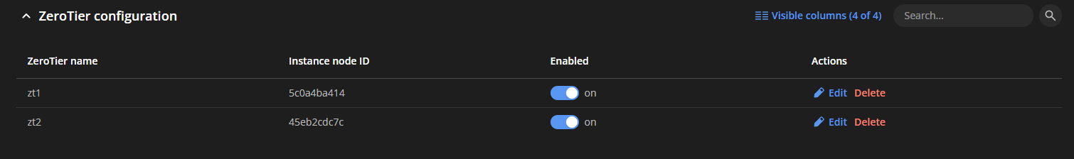

Information requested
  1. Are the two ZeroTier networks in one configuration or in two separate configurations/instances? Please include a screenshot, and confirm which network is missing.
  2. Please provide the full text output of zerotier-cli listnetworks, uci show firewall and uci show network.
  3. What are the IP ranges and managed routes of each ZeroTier network?
  4. For NW1–NW3, what are the interface names, VLAN IDs, subnets and current zones? Does all inter-VLAN routing take place on the RUTX50?
Greetings @Vilius
We have upgraded to the RUTX_R_00.07.24.5 FW.
Unfortunately this did not solve our issue of joining two zerotier networks at the same time.
We try to join the two networks within one configuration as described in my post of July 19.
The zerotier networks are configures as described in my post July 27.
