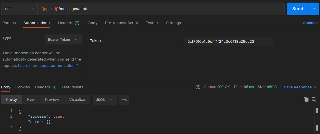

/messages/actions/send endpoint should work, do you send received token with API request?
There is official documentation with examples: https://developers.teltonika-networks.com/ just select correct device and FW version in top left corner.
Yes, I’m currently using this documentation and testing with Postman.
Any idea for my issue ?
When you do /login in response you get token. Copy value and add it to AuthorizationBearer Token.
