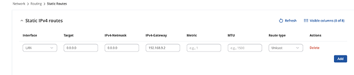

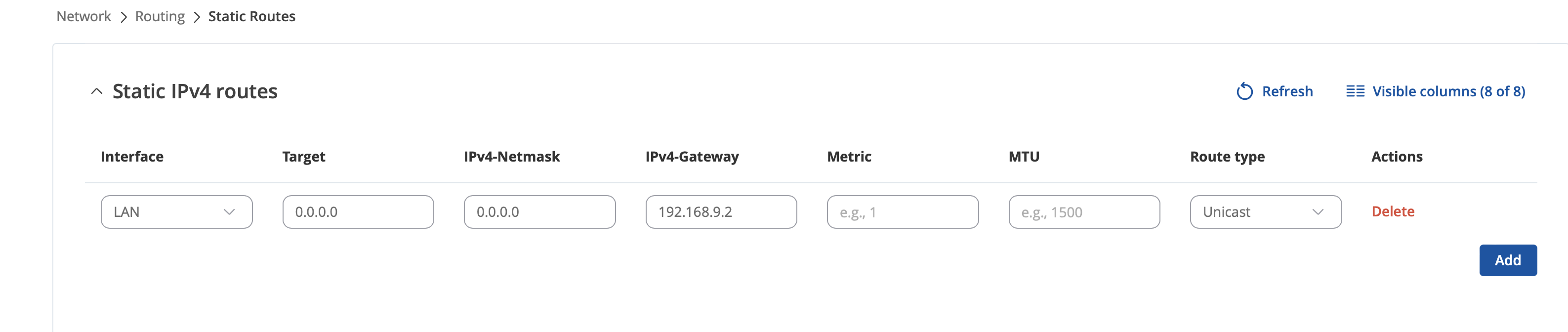

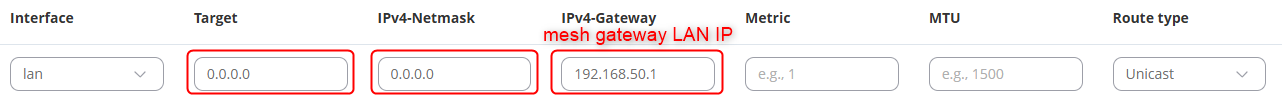

Hello @Malika.
Yes, that’s the intended behavior, as the mesh node does not have an active WAN source.
To enable internet access for the node or connected end devices, you need to create a static route on the node (Network → Routing → Static Routes) as shown in the screenshot below, routing traffic through the mesh gateway:

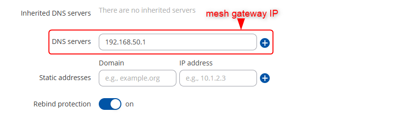

Additionally, for the node to perform a speed test or firmware update, you need to set the gateway as the DNS server in Network → DNS page:
With these configurations, the Mesh Node should have internet access and be able to resolve hostnames.
I hope this helps or let me know if you need any additional assistance.

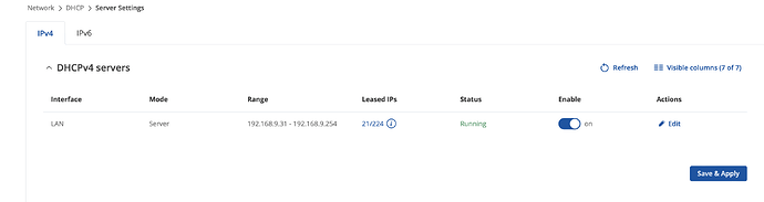

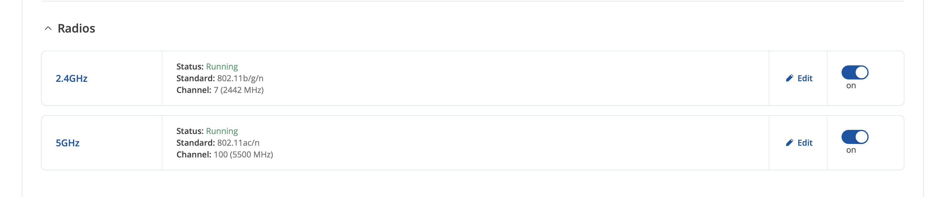

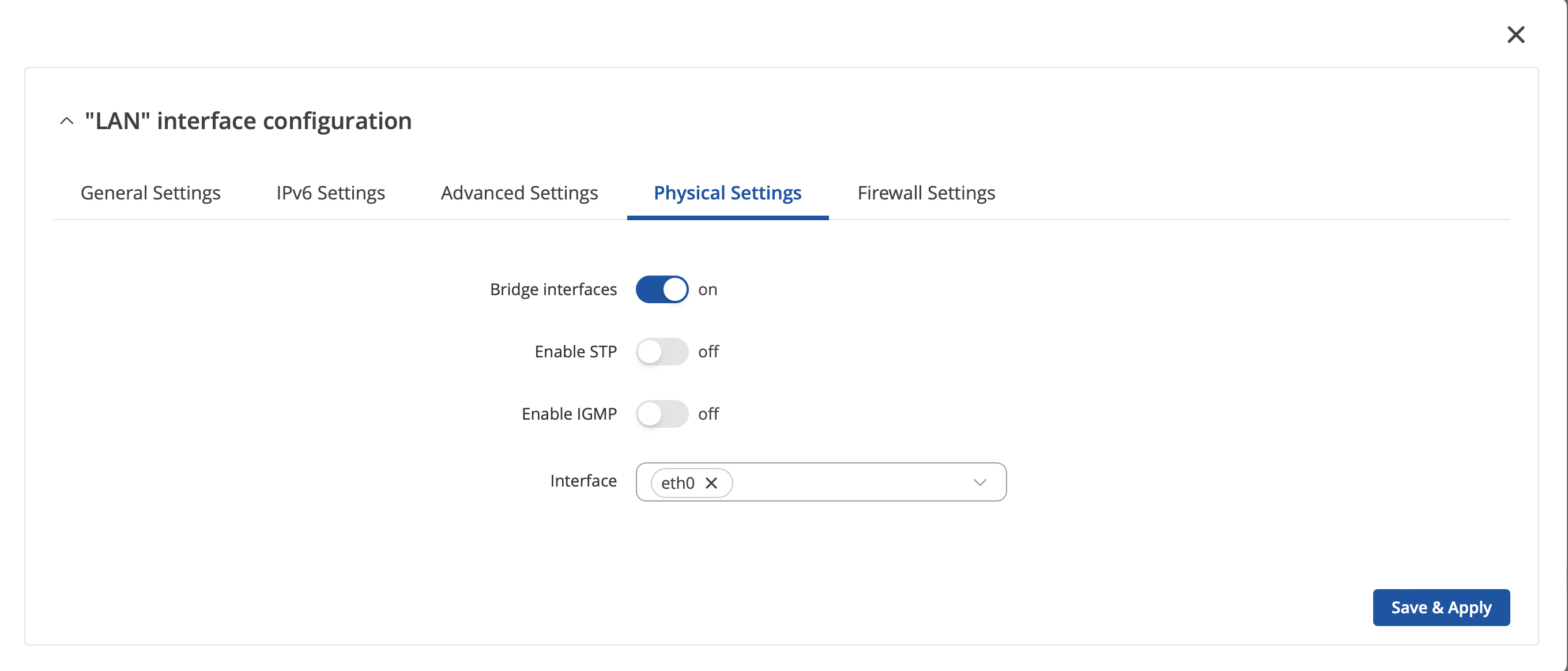

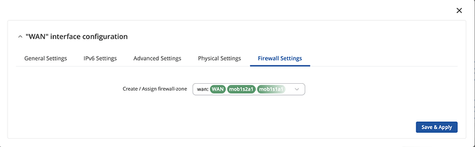

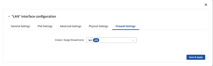

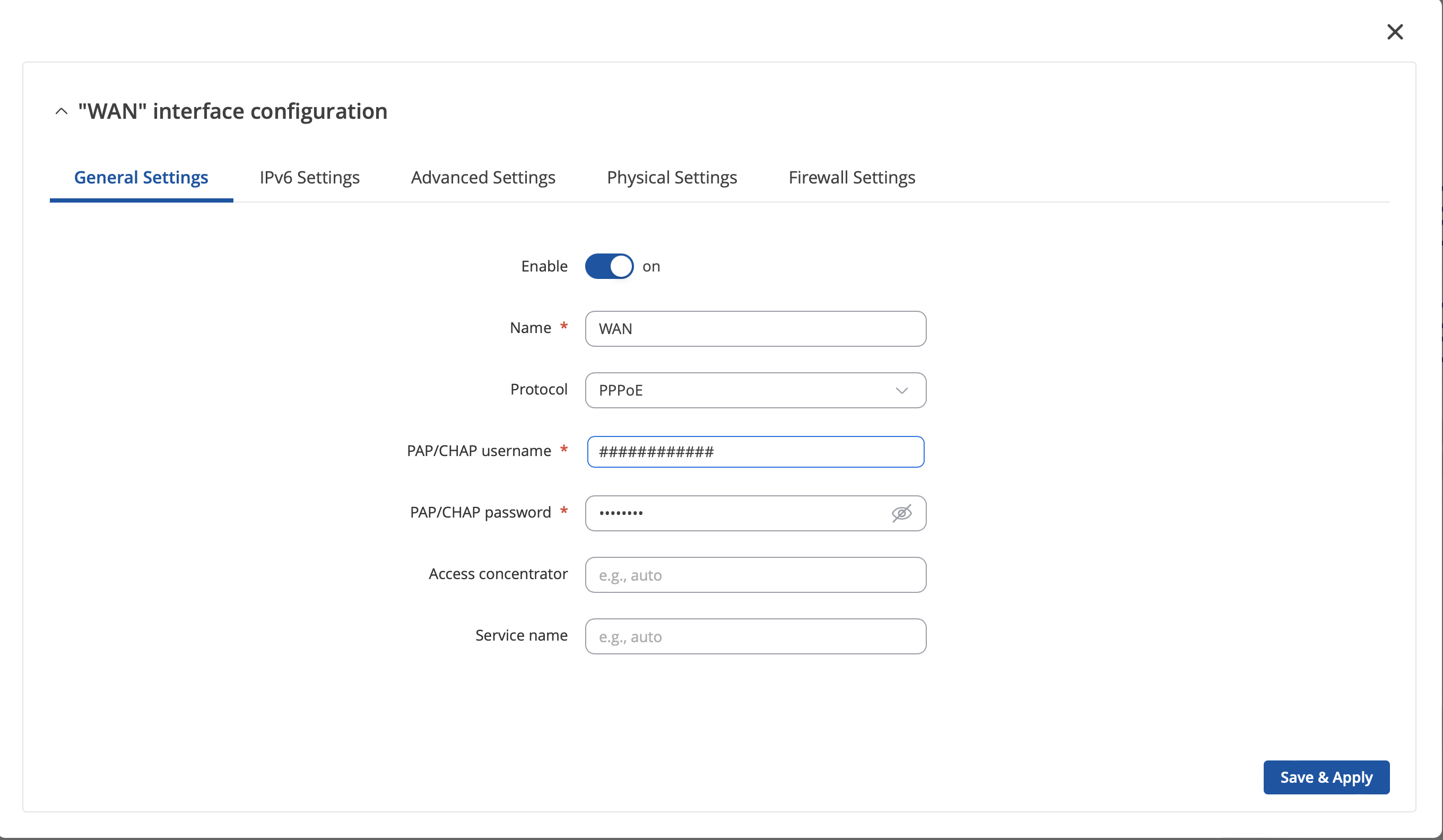

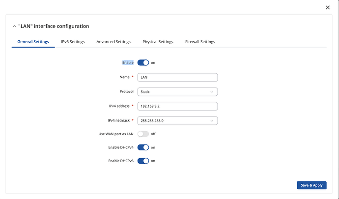

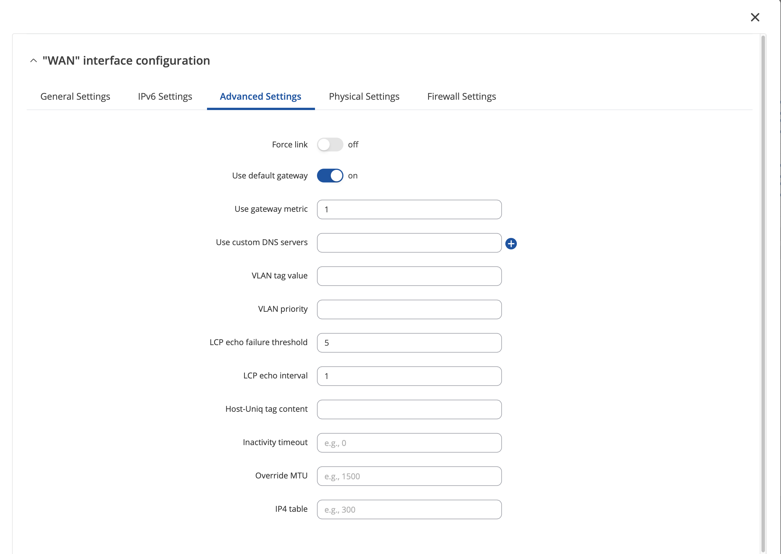

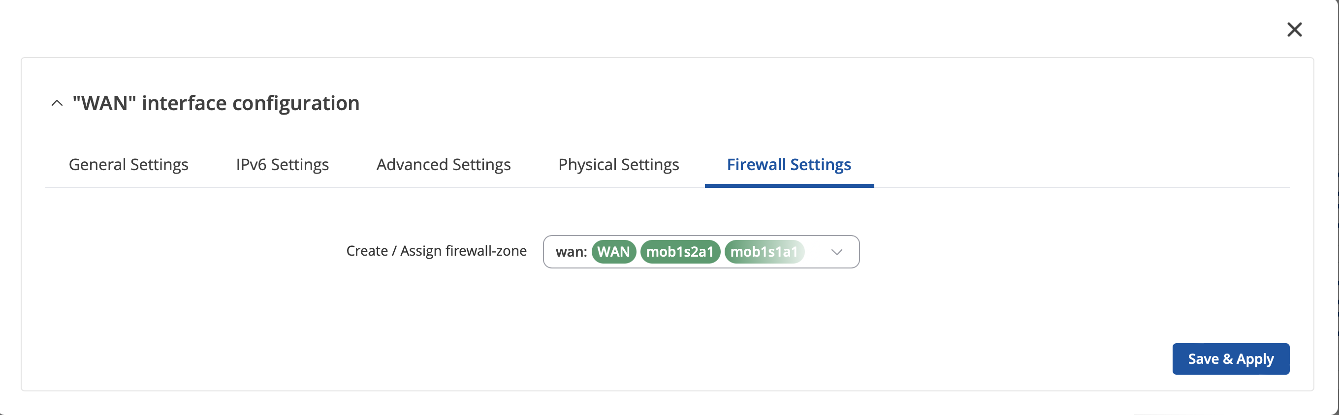

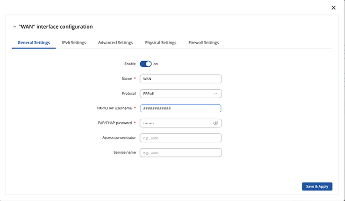

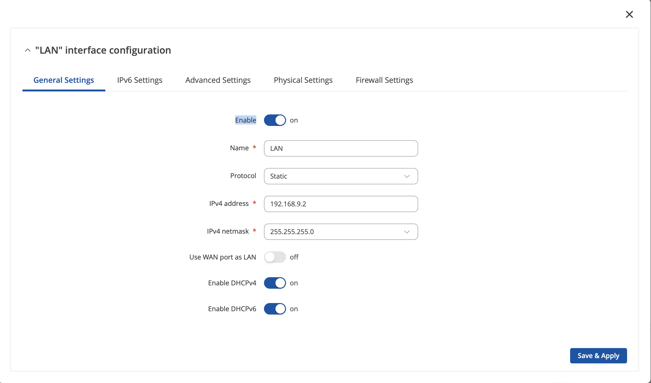

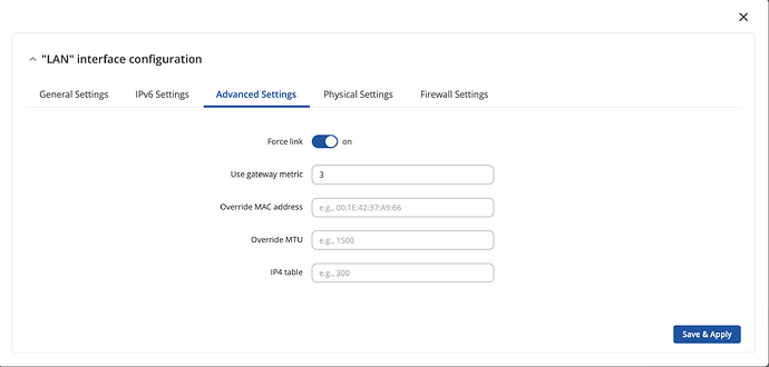

After activating the Wi-Fi Mesh system, my network performance has deteriorated. Ping tests indicate packet loss, and live video streaming quality is poor despite having a DSL connection with 250 Mbps download and 50 Mbps upload speeds.
Actual Configuration:
Mesh Gateway
“LAN” interface configuration
“WAN” interface configuration
DHCP
Wireless
LAN IP: 192.168.9.2
Wireless AP SSID: AP-03
Radios: 2.4GHz
Mode: Access Point
Encryption: mixed WPA2/WPA3 PSK/SAE (CCMP)
Additional Settings: Disassociate On Low Acknowledgement “On” / RSSI threshold for joining “-80”
Advanced Settings: Short Preamble “On” / WMM Mode “On”
Mesh ID: APM-244-07-01
Radios: 2.4GHz
Mode: Mesh
Encryption: WPA3 SAE (CCMP)
Additional Settings: Forward mesh peer traffic “On” / RSSI threshold for joining “-80”
Mesh Node
Static Routing
LAN IP: 192.168.9.3
Radios: 2.4GHz
Mode: Access Point
Radios: 2.4GHz
Mode: Mesh
Radio Settings for Mesh Gateway & Node: I use only 2.4
